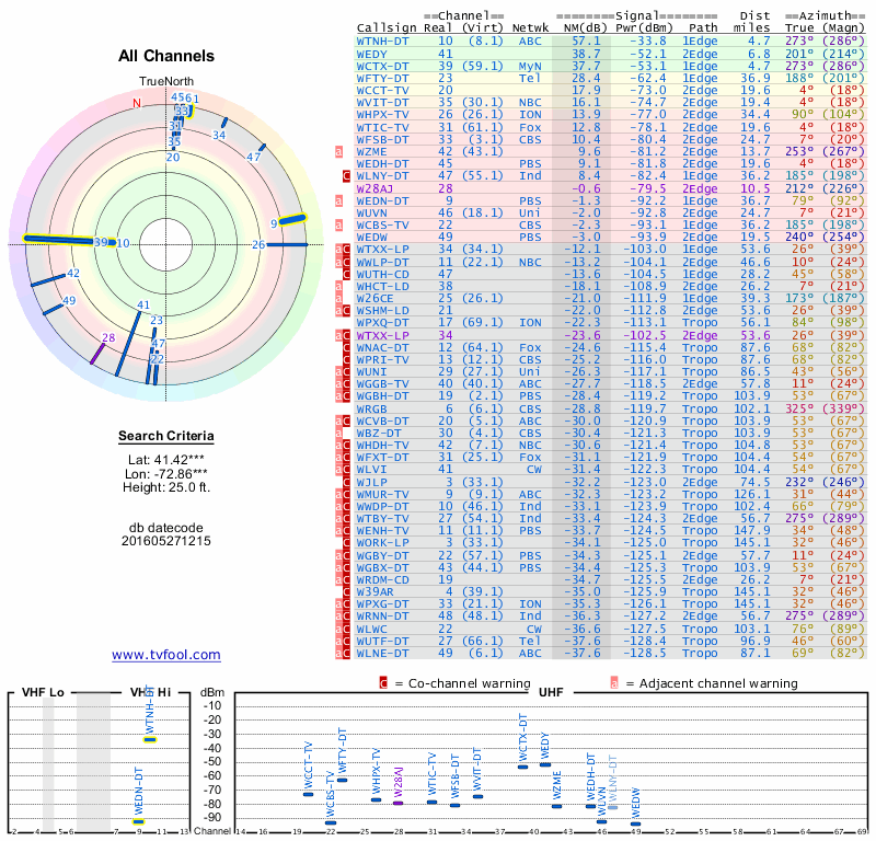

I recently installed an antenna in my attic (Antennas Direct DB8e) and have ABC, CBS, FOX and NBC coming in beautifully. We watch the Yankees on WCTX (UHF physical channel 39/virtual channel 59.1) twice a week during the summer. My problem with that is the reception on that channel is spotty. It is in the same location as the ABC affiliate, which is 4.7 miles from my house. The antenna is pointed in the right direction but I have to keep my fingers crossed every time I turn it on. I usually have a big problem with it between 6 and 10 at night. Before those times, it comes in much better but still not perfect.
What can be the issue? Overload? LTE interference?
My setup:
Antennas Direct DB8e (attic mounted) <25ft run to HDHomerun
Dedicated Server setup w/ NextPVR
View tv thru NextPVR PVR add in for Kodi on Amazon Fire TV

Please post a TV Fool Report made using the directions in this thread: http://forum.tvfool.com/showthread.php?t=14508
The information from the report is necessary to evaluate your issue. Also include antenna location (roof? attic?) and what is in the line of sight towards the broadcast towers.

Please post the link to the report (taken from the top of the report or your browser), and not just the graphic. In the linked version you can click on the station's call letter for additional useful information.
Also post the location of the antenna (roof? attic?). And direction it is aimed (239 degrees? Northwest? North-northwest?)

Thanks for the report.
Is the antenna aimed at 286 degrees magnetic for WCTX? The DB8e is VERY directional.
You are behind a hill and ABC is almost 20 dB stronger than WCTX. VHF signals can make it over a hill better than UHF signals. Click on its callsign in your report.

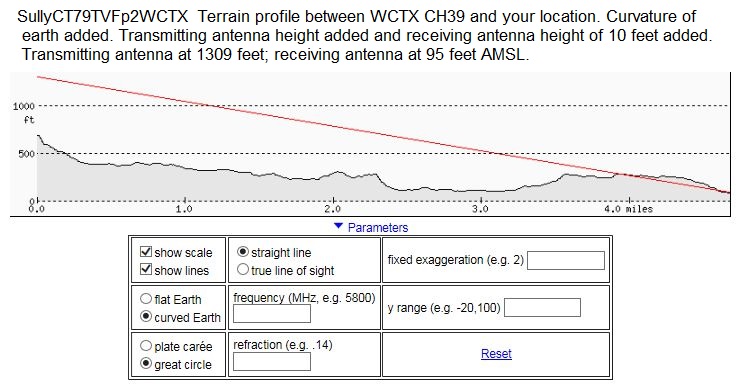

If you are getting the weaker signals from the north better than the stronger signals from the west, I think it is the trees.
Can you show us a picture of what the antenna "sees" when it is aimed at WCTX?
The WTNH antenna is higher on the tower than the WCTX antenna:
WTNH
Antenna Height Above Average Terrain: 1122' 342m
Antenna Height Above Ground Level: 800' 244m
Antenna Height Above Mean Sea Level: 1443' 440m
WCTX
Antenna Height Above Average Terrain: 987' 301m
Antenna Height Above Ground Level: 620' 189m
Antenna Height Above Mean Sea Level: 1260' 384m
OTA signals constantly vary in strength. I have measured changes of as much as 10 dB in a half an hour.
If the WCTX signal is weak enough to be near the "Digital Cliff" it will be a problem when it is weaker, and you will have pixilation, picture freeze, and finally dropout.
I think you will continue to have the same problem unless you can find a location in the clear for your antenna.
As far as the timing is concerned, that is most likely due to changes in atmospheric conditions, but it could be electrical interference in the evening.
This is what the hill looks like:

I moved the antenna to the edge of the attic and night 1 was a success. I'll keep an eye on it. If this doesn't work, I'll have to move it outside. But judging by your graphic that may not matter.
