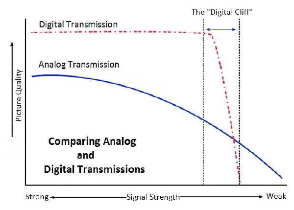

OTA signals constantly vary in strength. If they are marginal at your location, they can fall below the point of reliable reception.
At this time of year trees can grow more leaves that will block TV signals.
Electrical interference can cause problems with reception.
Intentional interference caused by someone else is possible, but very rare.
Digital TV signals are pretty much all or nothing, but there is a small zone between the two called the "Digital Cliff" where you will experience pixilation and picture freeze.
