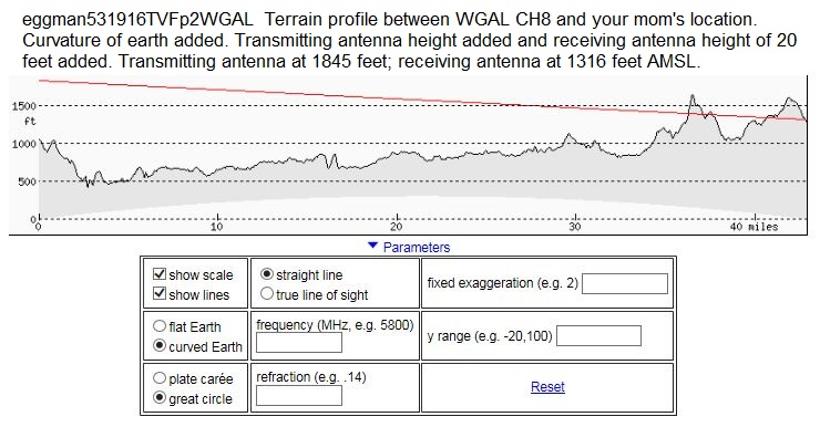

Also using the short coordinates, I did a terrain profile that puts her location along Pine Grove Rd route 233 in the Michaux State Forest between Fayetteville and Wenksville. There are some hills in the signal path from WGAL.

I did a second profile with the signal path from WGAL extended a little beyond your mom's location.
The problem I'm having is that, while she picked up an extra 13 channels, both 8.1 and 8.2 are now heavily pixelated and are her worse channels. I could pick up real channel 8 no matter which way I pointed a single antenna. the problem happened when I combined the two. I'm thinking that the channel 8 signal is so strong that it's still getting through the pre-amp on the Uhf side.
I also suspected overload until I did your FM report and saw another hill beyond your mom's location.
