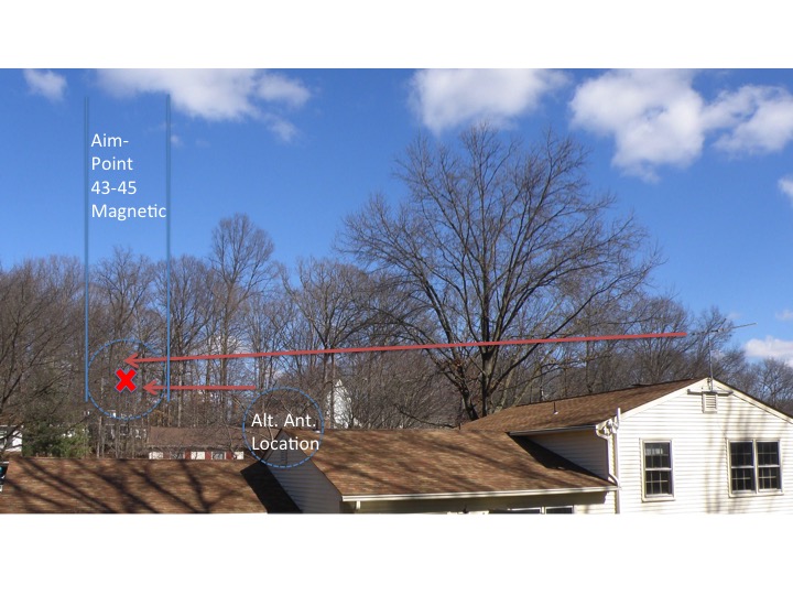

I have attached a "photo" (Antenna Placement Options) showing the current antenna installation and the optional / alternate location. This photo shows the challenges I have with both nearby and more distant trees that obstruct signal reception. I do realize that it is currently winter and there are no leaves on these trees.
Also attached is a .pdf (CM-2018 Pointing Sig Strength Record) showing my testing results of the antenna at the "desired/current location" on the back of the house, at the highest location. The current location is my preferred location as I think it gives the least objectionable visible installation location, to those who may not care for antennas. The .pdf also identifies my most desired stations to receive (ABC, CBS, NBC, FOX, PBS, MyNetwork, and ION) and other stations received plus their received signal strength. (Signal strength is determined by "meter" function in my primary TV. Steady signals above 50-60 in strength are received with good quality. If I can make an antenna work at this location, that would be preferred!
However, I do prefer a functioning antenna and will consider moving it to the alternative location (over my garage with less nearby tree blockage); if necessary to receive consistent strong signal quality. Using the alternate location would add cable length from the antenna to the "old cable interface" of at least another 25 feet.

So let me understand this...... You had to point your antenna 180 degrees opposite of Real Channel 9 to get a good signal? I'm not so sure that antenna is the right option for you. Can you return it?
Your TVFOOL report looks great. Wish mine was that nice....lol
I think your on the right track with moving the antenna to a better line of site. IMO a better antenna such as the Antennas Direct C2V might be a better option. It could be tested in your current location and without a preamp but if those trees are going to fill up in the summer I'd strongly recommend moving the antenna to a better LOS option either now or when summer comes. I'm not sure that inline surge protector is helping you out. I personally don't have experience with one but I have never seen to recommended to be used. The COAX should be grounded before it comes in the house. You could also add a ground wire from your splitter inside to a ground in your electrical panel. You internet COAX may already be connected that way.

- Yes, I did "OFF Point" to favor the CBS VHF signal. I was installing this antenna in the week following a large snowstorm, and only had access to the mounting point via a 24 foot ladder. There was about a foot of snow on the rooftop. So, each time I tested the received signals by adjusting the antennna pointing for best signal reception, the ABC VHF signal was strong but the CBS signal was weaker and of poor quality (pixelating). The UHF channels desired were generally coming in strong when pointed at 44-45 degrees. With the Super Bowl approaching, I just needed a strong CBS signal. I know that antennas will pick up signals on their back side, and I was running out of daylight. I did a quick test of pointing about "180 out" and "WOW" CBS was one of my strongest received signals. I locked this position down, and my helper left with his ladder. CBS worked fine throughout the big game.
- I have already learned that the large tree in my front yard does indeed obscure the antenna in its current location. This is even without leaves on it! So, I will move the antenna to the alternate location over the garage. Just need to do this on a warmer / dry day. This is why I chose not to even try an attic installation, as the front of the house (where attic installation would make sense) is beneath the large tree.
- I know my TVfool report does look great. But, the house site is "OTA challenged" as it sits down in a slight valley with trees all around. You can see the distant trees sit up on a ridge line. Beyond the ridge (high ground with a roadway), lies nice and clear shot to the towers of interest.
- The antenna location over the garage will have a much less obscured view from nearby trees (in my yard). However, there is a distant tree line behind the houses across the street. Those trees are on ground that slopes "upward" / and are slightly elevated from my house. My rooftop is probably at the same elevation as the driveway of the home (you can see in the attachment) directly in the aim-point angle. Those trees "fill in property" between the homes and are not a thick forrest. But, they are large oaks and poplars that will fill out with leaves. These more distant trees are in my LOS/path to the desired TV towers. See question below.
- I have 90 days from purchase to return the Channel Master, if required. ~ Mid-April. Time to play.
- I will route the RG-6 from the new antenna location by the shortest possible route. Perhaps adding ~15 feet to my total runs. To do so, I will get a length of quad shield RG-6, exterior grade connectors, the appropriate stripping / compression tools. I will make sure all interior cables are of this quality.

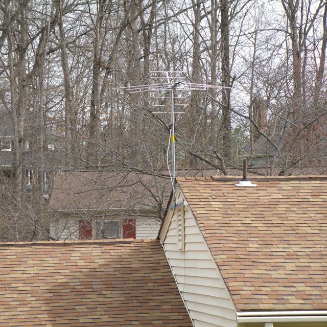

Progress Update - Looking Good!
Mother Nature gave us some unseasonably good weather, with three days near 80 degrees in this area. So, I could not make any excuses to not get this work completed. I successfully moved the Channel Master CM-2018 to my alternate mounting location, without a helper too!
The new location involved installing a new 8 foot grounding rod (much easier and cheaper than I thought), plus installing an a/c outlet to accommodate the power source for the preamplifier. The antenna location required approximately 60 feet of cable to run to the house interior cabling interface. I pointed the antenna in the correct direction ~44-45 degrees and locked it down, then I ran my ~60 foot or RG-6 Quad Shield from the antenna balun directly to the tv tuner input (temporarily moved the TV). The results were very good. Then I connected the FM Filter, and Preamp plus this required using a couple of short cables. The results were better yet! Then I finalized the installation by connecting the 60 foot cable to the interior cabling and put the power inserter just ahead of the splitter. The results were outstanding on both TVs!
My current setup is:
- CM-2018 antenna --> (mast is grounded with #8AWG solid copper wire to house utility ground)
- short coax (the black coax that came with Juice Preamp) -->
- FM Filter -->
- male to male f type connector -->
- Juice Preamp -->
- 60 feet of RG-6 QUAD shield cable -->
- TII network technologies TII 212 in-line coax surge protector (grounded in old cable interface box) -->
- ~10 feet of RG-6 Cable (penetrates exterior wall) -->
- Power Inserter for preamp -->
- 2 way splitter --> From the splitter approximately 25 feet of RG-6 to wall plate at my primary TV (with signal meter function built-in) then 6 feet of coax to TV input. Basement TV has about 40 feet of RG-6 (w/ one in-line cable to cable connector) to the TV input. (Total runs of: ~ 101 ft of cable to primary TV, ~ 110 ft of cable to basement TV)
Attached are two photos of the installation. The close-up photo best shows the one "tree variable" that I control; and that is a cherry tree next to my driveway. That cherry tree can/will be trimmed if necessary. The more distant trees can be seen in the other photo and are about 150 feet distance. These trees are my main concern going forward. I am anxious to see how these will impact my reception. We will see over the next couple months. . .
With this antenna relocation and the addition of the Juice Preamp I can say "awesome" improvement was achieved. Attached is my pointing and testing results record. This record shows the preamp is boosting the received signal strength as seen by the television. This record shows that I currently have very good quality reception on all of the desired channels. Now, I am missing "cable TV" very little. The total cost of this installation is completely covered by less than 4 months of the old cable bill.
I will continue to work on the interior cabling, to ensure Quad shielded runs throughout. I suspect this will/may limit some transient interfering signals. Any thoughts?

If you have a great picture and nothing you operate is creating havoc on your signal, you should be all set with not replacing everything to Quad-shielded. Not sure how much of an advantage they have to be honest.
I don't know what installing the FM filter backwards will do. Maybe someone else knows. I did however notice that once I installed the Juice preamp in place of another preamp, I did not need the FM filter any longer. The Juice is very resistive to overload. You could find the same thing and it may help your VHF channels slightly as long as there is no interference. It did for my but I did have 2 filters. Worth a try.
I'm a little confused on your chart. I thought RF-23 was a worship channel and IND is actually broadcasted at RF-14?
