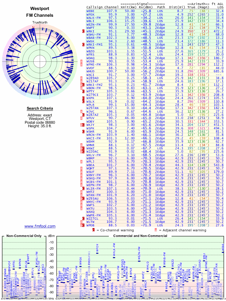

I have attached the FM Report.

Originally Posted by rackit7 View Post
Thanks, appreciate the advice.
You may need to install an FM filter after installing the preamp if you have signal fluctuations. The Radioshack 1500024 is an example which I used. I believe Antennas Direct and MCM Electronics also makes them.
