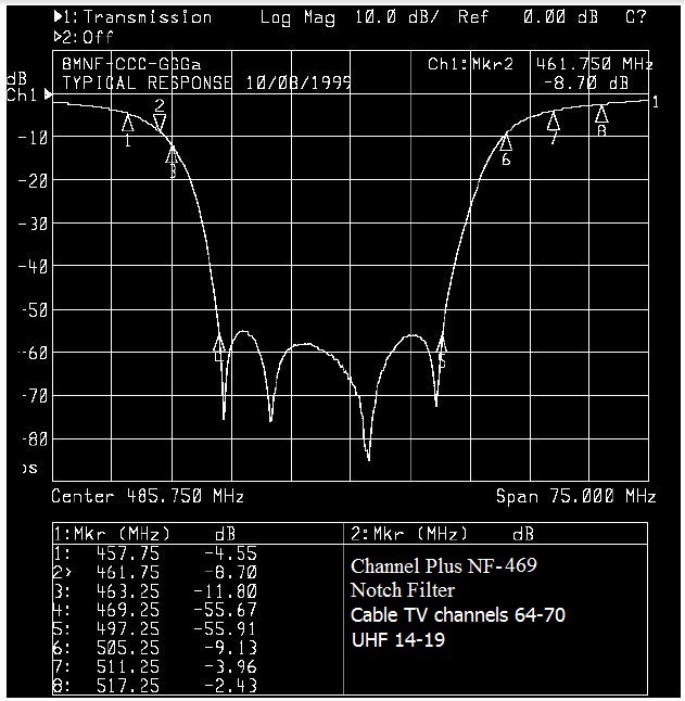

The attachment has the filter curve for the NF-469, which covers lower channels, to give you the idea. I don't have the curve for the NF-471.
This is the data sheet for the NF-469, not the NF-471:
http://www.markertek.com/Attachments...ifications.pdf
