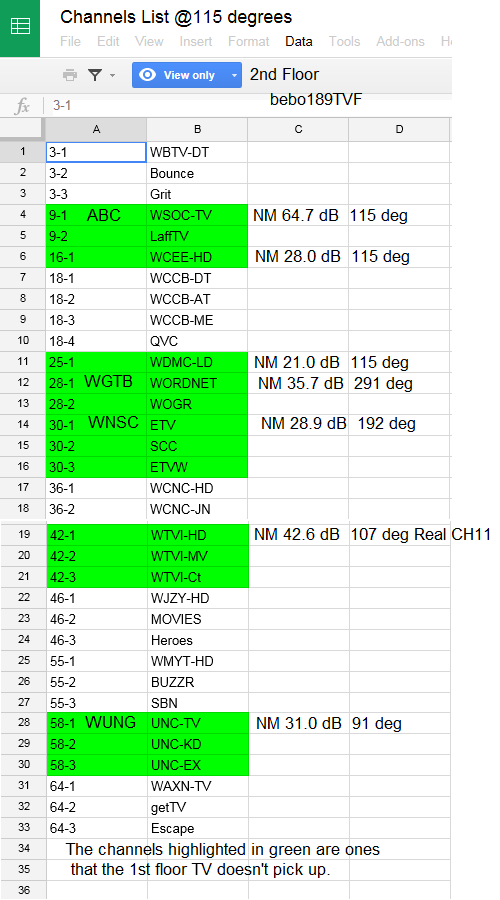

Here's the channels I get on each of the TVs. Each TV has it's own tab. On the 2nd floor TV, the channels highlighted in green are ones that the 1st floor TV doesn't pick up.
bebo189 is offline   Reply With Quote

OK, got your 1st Floor list using View Only at Google Docs. A lot of signals coming in the back of the antenna.

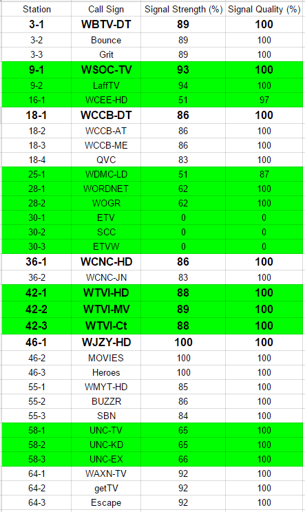

Yes, I have the 3412 plugged into an outlet in the attic using the AC adapter that came with the 3412. The AC adapter is connected to the unit via a coax cable.
I went ahead and used the instructions you posted to get the signal strength/signal quality readings for each channel on the LG 42LD550 (2nd Story TV). Here they are:
Reminder: Green is channels I get on the 2nd Floor TV but not on the 1st Floor TV. Bolded Channels are the ones that I actually WANT to get on both TVs.
I am not sure what the difference is between "Signal Strength" and "Signal Qualtiy" as called out on my LG 42LD550 TV.
Also, the weird thing to me is that is that the main channels that I want to get on the 1st Floor TV, but only get on the 2nd Floor TV (WSOC-TV, WTVI-HD, WTVI-MV, WTVI-Ct) all have "Signal Strengths" on the 2nd Floor TV of 89% or higher. In fact, there are stations that I got on both TVs, for which the signal strength on the 2nd Floor TV is lower than 89%. Doesn't really make any sense to me.

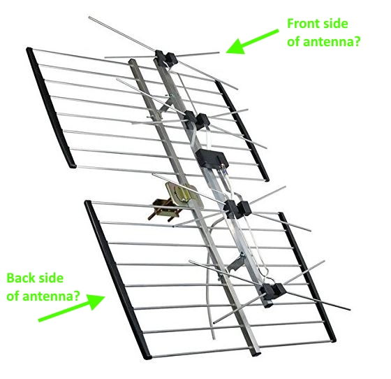

Also, can you confirm that "front" and "back" of antenna is as I think in the picture below?

No problem; it takes time to do it right. And it's going to take time for us to digest your results and think of an intelligent helpful comment.
Every manufacturer does it a little differently. The percent scale is only relative, not absolute, but it is very useful for comparisons. The signal strength is similar to the NM dB or Signal pwr dBm scales on your tvfool report. The Signal Quality is probably SNR (Signal to Noise Ratio).
Your labels are correct.
It doesn't make sense yet to me either.
There are three possibilities. The loss in the coax line to the first floor is more than estimated. As a test, run a temporary coax line to the 1st floor to bypass the in-wall coax run.
The 1st floor tuner is more sensitive to overload than the tuner in the 2nd floor TV. Try inserting various values of attenuation between the antenna and the input of the 3412. A 2-way splitter has a loss of 3.5 dB, a 4-way 7 dB.
For "Signal Quality", I assume 100% is the ideal? Almost every station was at that value, so it looks like I don't have any signal quality issues.
My observation below would seem to cast some doubt on the first possibility, wouldn't it?
...main channels that I want to get on the 1st Floor TV, but only get on the 2nd Floor TV (WSOC-TV, WTVI-HD, WTVI-MV, WTVI-Ct) all have "Signal Strengths" on the 2nd Floor TV of 89% or higher. In fact, there are stations that I got on both TVs, for which the signal strength on the 2nd Floor TV is lower than 89%."
I will have to look into the other 2 possibilities. Finding a cable long enough, or a short enough path for my existing coax could be an issue. I could possibly run from the antenna straight to the wall the 1st Floor TV is mounted to, but I'm guessing I'd run into some 2X4s going down 2 stories. If only I could get signal strength readings from the 1st Floor TV.
Is it safe for me to assume that you do a tuner rescan of the 1st floor TV after a change?
Yes.
