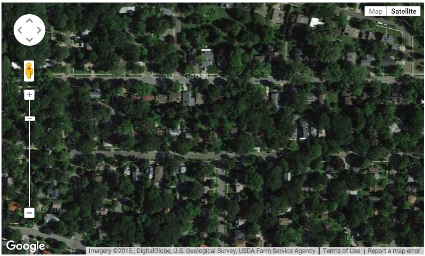

I see a lot of trees in your area. If it isn't the trees, it's fundamental overload from TV and FM signals.

I mounted my antenna a week ago and I picked approximately 15 deg. as a starting point. By the time I connected my system on 12/23 the roof was too icy to adjust the antenna.
There are many, many trees as you could see in the satellite image (your estimated location was correct, KBEM-FM is 0.8 miles away. With tree interference, is the best option to rotate/relocate the antenna until I get the best signal?
Try to relocate the antenna to avoid the trees as much as possible as ADTech said in post#4; trees block signals.
