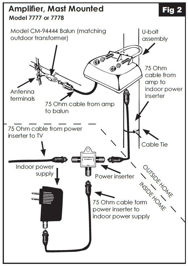

Sorry to hear you are having trouble; it should work if my analysis is correct. Maybe ADTech will check my analysis.
There is a Channel Master troubleshooting page for the 7777:
http://support.channelmaster.com/hc/...ing-correctly-

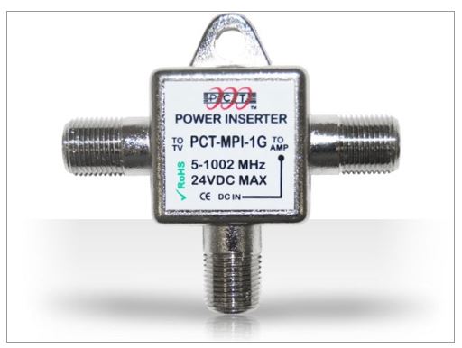

What you call a splitter should be the PCT power inserter, and it sounds like you connected it correctly.

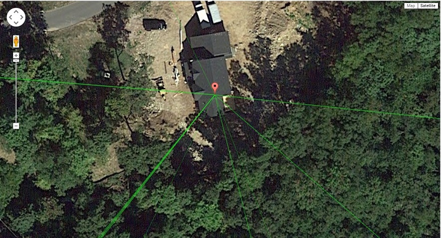

Your tvfool report was only resolved to street level. A more accurate report should be done with exact address or coordinates, which will not show in the report. We have found that 2Edge reports can be way off, and when you are on the fringe, the coverage is very spotty. A small change in location can make a big difference in signal strength; much stronger or much weaker.
Use the interactive map browser and move the indicator to your antenna location.

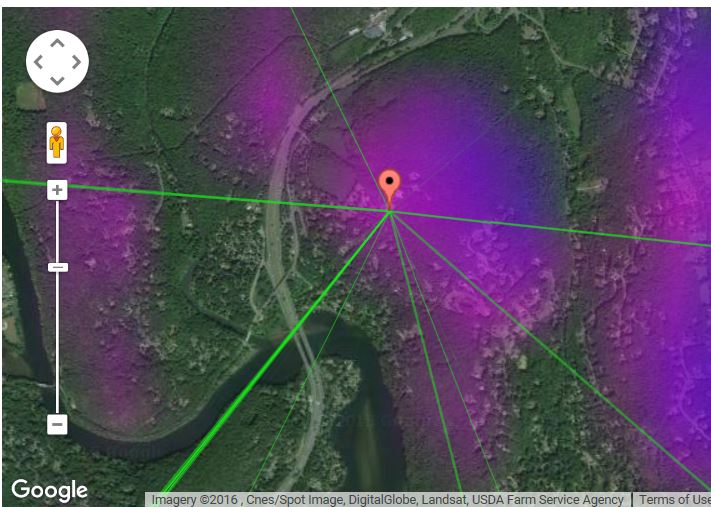

Satellite Map Image w/signals
According to the attached image, FOX in NY appears to "relatively" strong.. (SW direction)

It does sound like a bad power inserter. I'm wondering if it was bad when you received it, or did something cause it to go bad after you got it. The power transformer has a device that protects it from a coax short, but the power inserter might not survive a short in the coax going to the 7777.
I'm assuming connecting a regular splitter in the place of the power inserter would fry the TV?
It might damage the TV and fry the splitter. A power inserter contains a capacitor that keeps the voltage out of the TV but allows the signals through.
The PCTMPI1G power inserter has markings on the label to show the correct way to connect the cables. The side marked “To Amp” should never be connected to the TV. This port will have 12VDC on it, and it is possible that older TVs can be damaged by that voltage. Newer TVs should be protected, but not all may be protected.
http://www.channelmaster.com/Amplifi...p/pctmpi1g.htm

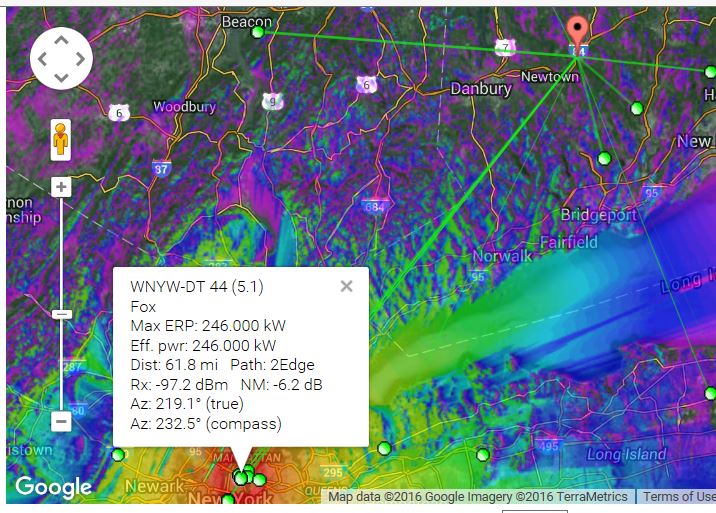

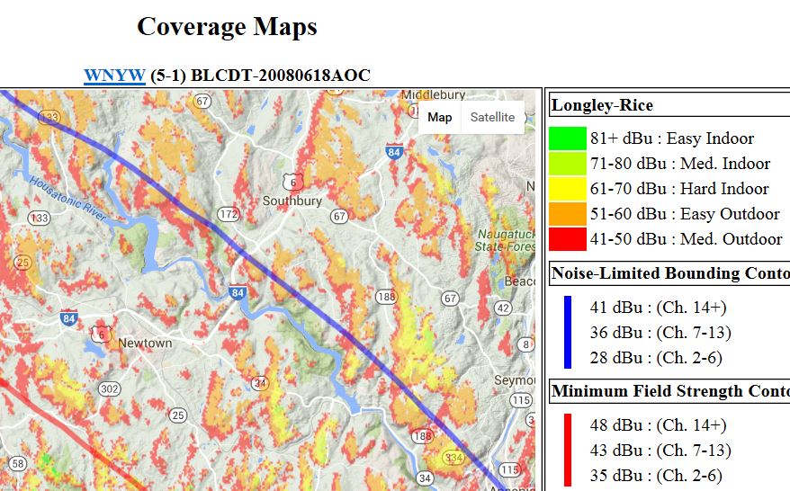

Which Fox is that, WNYW real channel 32, NM -6.9 dB or WNYW real channel 44, NM -8.2 dB? They don't look very strong to me.
http://www.tvfool.com/?option=com_wr...ALLTV%26n%3d21
http://www.tvfool.com/?option=com_wr...ALLTV%26n%3d26
The coverage for 5.1 looks very spotty in your area. You are on the fringe.
