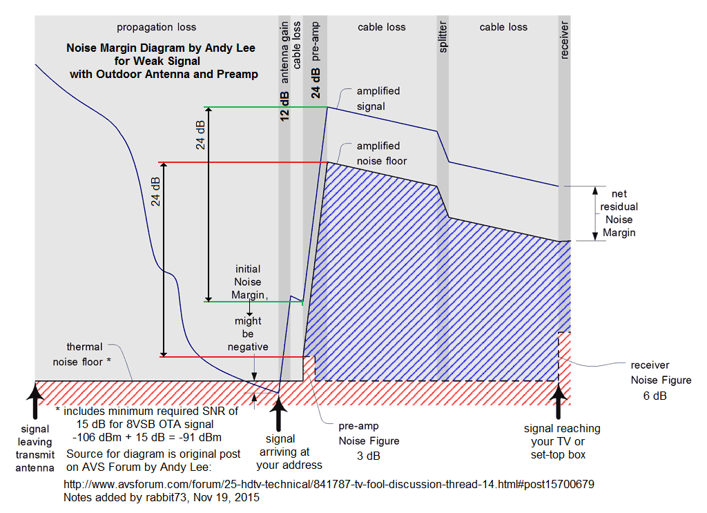

A reminder that antenna gain is the ONLY thing that improves the noise margin. Amplification actually reduces NM by the amount of the amp's noise figure as the amplifier also increases the noise floor by the amount of amplification (plus the NF) resulting in a net decrease of NM. There's a note to this effect in the signal analysis FAQs.
Therefore, the equation should read:
-10 -2 dB preamp NF = -12 NM
Signal power was increased by the amount of amplification as was the noise floor.
Old 15-Nov-2015, 2:07 PM   #6
True, antenna gain will improve the NM; preamp NF will make it worse. But the use of the preamp will improve the System Noise Figure, so I think I am justified in adding the preamp gain as long as I subtract the preamp NF. If you subtract the preamp NF you must also add the preamp gain when considering the whole system, and not just the head end. My original 7777 certainly helped with my crappy signals, with a DB4e, a folded dipole for VHF-High, 50 feet of RG6, and my antenna at 5 feet AGL.
COMPARE System Noise Figures
With and Without Preamps
Why do you think it is proper to subtract the harm to the NM that is done by the preamp NF without adding the benefit to the System NF by the preamp gain, its superior NF, and placement at the head of the chain as proved by the Friss Cascaded Noise Figure Equation?
Andy Lee also states that in a post:
http://www.avsforum.com/forum/25-hdt...l#post15700679
Everyone should note that the antenna is the ONLY element in the system that helps you GAIN Noise Margin.
A pre-amp does not change the intrinsic gain of the antenna. Amps boost the signal and noise floor simultaneously, so a crappy signal going into an amp will yield a strong, but even crappier signal (because of the amp's Noise Figure) at its output.
Do not be fooled by lousy antennas that include a built-in amp and claim to be high-gain antennas. The amp's gain does NOT count toward the gain of the antenna itself.
But if you look at his second image in that post his analysis takes into consideration the harm done to the NM by the preamp NF AND the benefit provided by the preamp gain to turn a negative NM into a positive NM. See my attachment 2.
To put it another way, note that Andy adds the preamp gain at the same time that he adds the preamp NF to the Noise Floor. Why can't I do the same thing?

I added some notes to Andy Lee's Noise Margin Diagram to help me understand it better. FYI, Andy created the TV Fool website. His original NM diagrams can be found here in post #397:
The dB values match his original scale; 3 dB for an average preamp NF, 6 dB for the ATSC estimate of the tuner NF, 12 dB gain for a 4-bay UHF antenna, and 24 dB gain for a preamp like the original CM 7777.
Old 20-Nov-2015, 5:16 PM   #11
Here is a more compact revision of Andy Lee's Noise Margin Diagram that is 878 x 738 pixels without reducing the lettering size, so I'm showing the image in this post. The previous version is 1024 x 743 pixels, Andy's original size.

This is a Noise Margin Diagram that I did to help me understand the concept:
