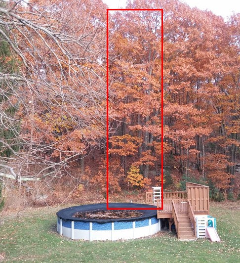

Google Earth view. House is marked at WHITE ARROW. The picture has NORTH on the LEFT, EAST at top. The Red X is where the antenna would be. According to google earth, the yard sits at 575' above sea level. The WHITE X marks the highest point, per google earth at 645'. Mind you there are oak trees which are taller. Beyond this highest point, it drops off...straight shot to Boston.
http://i99.photobucket.com/albums/l3...105151533a.jpg
I am about 10 feet below where the antenna would be. There is a maple tree to the left. The camera is about 18' off the ground.
http://i99.photobucket.com/albums/l3...1105151533.jpg
The view to the roof. Taken from same place as above picture.
I hope these pictures help.

I would recommend a DB4e mounted to the chimney aimed directly across the swimming pool.
I will also recommend trimming the tree limbs to the left and also turning the trees directly beyond the pool into firewood (if you own them) so as to create a gap for the signals to get to the antenna. If you do not or cannot do this, your reception WILL be at the mercy of the trees and all bets are off.
I own the whole hill. Sadly can't afford to get the trees cut down. Oh how I wish.

Thanks for the photos.
Wouldn't harvesting pay for the cutting?
I agree with ADTech on the DB4e.
If you can't cut trees, can you go higher with the antenna?

It took me about 4 minutes. I'd delete the overhead photos, though, since they made it possible to be precise so quickly. The typical TVFool plot allows me to usually get to an area about the size of four football fields if there are stations in three directions I can use to triangulate from.
Once those trees loose their leaves for the winter, then reception will probably stabilize until spring. In the photo below, the red box indicates your incoming signal path. If, at a minimum, that clump of trees in the right side of the box could be topped or eliminated, it would create a notch in the treeline and would help tremendously to allow the signals to get to a roof-mounted antenna.
A 10' mast on the chimney should get the antenna about 35' off the ground and I'd consider that the practical limit for an inexpensive install.
When it comes to removing the trees, if they can be safely dropped without hitting anything, it isn't too hard to find wood-burning home owner who would do it in return for the usable wood. Craigslist usually works for that, especially if you don't expect them to do the clean-up of limbs and such. If there's a risk of a falling tree hitting something, then the job is best left to a professional crew who can take the trees down in pieces.
