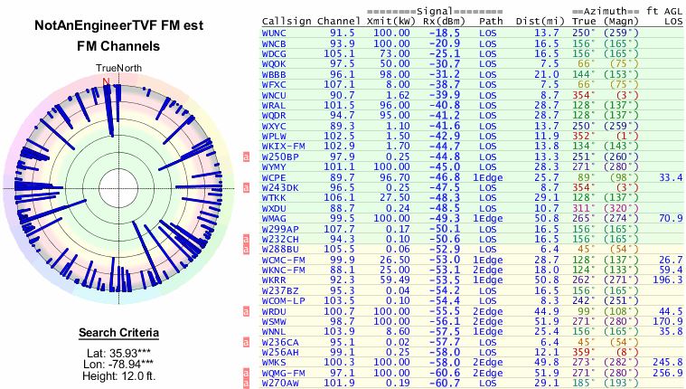

You have some strong local FM signals that might interfere with TV reception. You should insert an FM filter in the coax line or use the FM trap in a preamp. See attachment 5.
