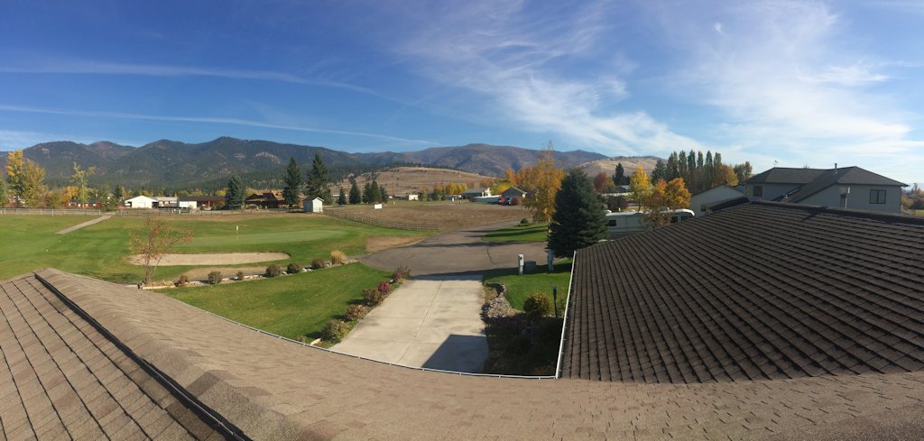

From my understanding of where the broadcast tower is I do not believe I have any visual obstructions. I will try to update with photos from the antenna level either later this week or weekend (when home with daylight).

Hi Folks,
I got up on the roof this morning and played around for a couple hours with things.
Disconnected Pre-Amp
- No change at current mast location (0 strength)
- Found a portion of the house above the garage where it did receive signal (~40% strength) enough to pick up football with no issues.
Re-connected Pre-Amp in this new location
- Increased strength by ~10% (to 50+%)
I then moved incrementally around the roof varying the antenna height/orientation. This exercise demonstrated:
- A band (10-20') wide on the roof where I picked up signal. This band tended to be weaker the higher I raised the antenna from the roof, with a sweet spot being ~3' above the roofline. As I got to the fringe of the area the dropoff was quick from ~30% to 0%.
Since the Pre-amp increased my strength previously I left it connected and disconnected the VHF antenna. I then incrementally moved around the roof with the antenna. Strength levels were similar to what they were when both were connected; however there may have been a slight gain.
Upon completion of the testing I re-installed the antenna on the existing mast and took photos from two vantage points that are attached.
Existing Mast Location (Current Mast Location.jpg)
Where I picked up KTMF (Pickup Location.jpg)
Based upon my experiments I'm thinking my set up has some combination of the following:
1) Poor mast location for KTMF
2) Inadequate UHF antenna
3) Potentially inadequate gain/pre-amp
Moving forward it would appear I could
A) Install a mast where I can pick up signal (This option would require a lot of work on my part, require mounting/runs on a roof that may need to be replaced soon, and could upset neighbors)
B) Experiment with a different Pre-Amp to increase gains at current location
C) Experiment with merging 2 different antenna signals at current location
Options B & C have the definitive risk of doing nothing if current mast location is in a blind spot.
In performing the tests I found it very strange how there was such a limited window (with the existing antenna) where I could reliably get signal, and that raising the antenna much above the roof-line seemed to generally hurt reception.
I guess my questions are:
1) Is there a good explanation on why raising the antenna would hurt reception? (I thought KTMF was LOS, for which higher is better)
2) What is the likely hood I can pickup signal at my existing mast location by playing with antenna/pre-amp choices?
3) Is there any additional tests that I can do with my existing equipment to help provide clarity?
Again, I appreciate all the time and help that folks have put in to this point.
FC
FrenchConnection is offline   Reply With Quote
The signal wavefront is non-uniform and has layers of weak and strong areas. One possibility is roof reflections of the signal that add to the direct signal that enhance it if they arrive at the antenna in phase.
Another location sounds better; sometimes the best location for the signal isn't the most convenient. But don't give up on the present location until you have completed all the options suggested by Mike.
Your existing antenna location has the roof in the foreground below the antenna. The new location has bare ground. The signal is reflecting off the ground and reinforcing incoming the signal.
To understand why, read this: http://www.hdtvprimer.com/antennas/siting.html
Especially this section:
"The ground reflection can be very helpful. Assume the power in the incident wave is P. If the reflection is 100% efficient, you might expect the power in the overlapped area to be 2P. But instead it will vary from 0P to 4P. (Power is the square of voltage. Where the voltage doubles, the available power goes up by 4.)
If you can put the antenna in the most intense spot, it will collect 4 times as much signal as with no ground reflection (assuming a 100% efficient ground reflection)."

Thanks for the input.
Rabbit73, I do not have a UVSJ thus the disconnect.
Tower Guy, thanks for the info & link. Its been a long time since I had a physics class looking at waves and their resonance/dissonance effects from reflections . However, the diagrams make a great explanation on why I had a vertical band. The reflection off of the pavement would also explain the lateral distance that I was able to get feed.
So what this seems to be telling me is that there could be KTMF signal at my mast location, but without the added strength from the reflection the antenna doesn't pick it up.
