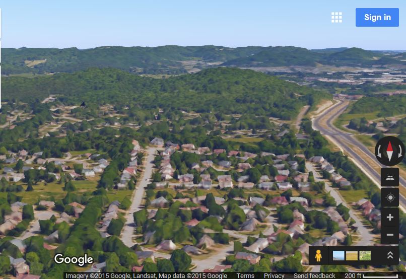

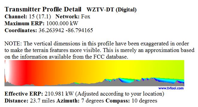

For your attic location, with a terrain obstructed path for the Fox signal, you do not want and should not use an "omnidirectional" antenna because your desired signals are all in the same general direction, and Fox is your weakest desired signal. Look at the terrain obstructions for the Fox signal on its way to your antenna:
And notice that only about 20% of its max 1000 kW of power is being sent your way.
Here is another type of profile that shows the hills:
And I see the hill in attachment 4.

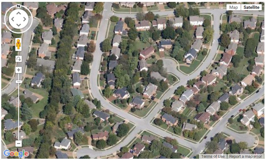

I see a lot of trees in your area that might block signals; see attachment 1.

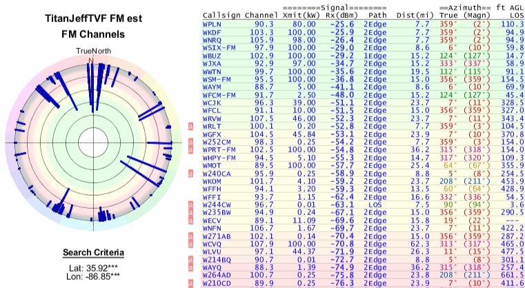

You do have some strong local FM signals that might interfere with the reception of NBC; an FM filter might be needed. See attachment 5.
