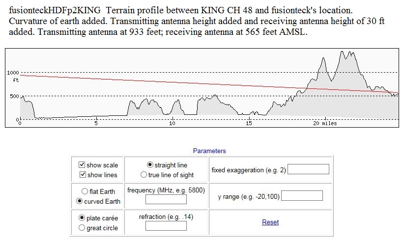

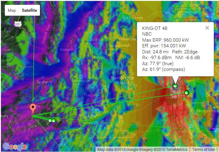

KOMO ABC, real channel 38, virtual channel 4.1, NM 1.1 dB
KING NBC, real channel 48, virtual channel 5.1, NM -6.9 dB
KIRO CBS, real channel 39, virtual channel 7.1, NM -7.4 dB
Do I see solar panels on your roof? See attachment 5.
Inverters can create interference for TV signals. Modified sine wave inverters (should be called modified square wave inverters) create more EMI than sine wave inverters. The interference can be conducted, radiated, or both. Some users need to move the antenna away from the inverter and run the TV on a small sine wave inverter like the Exeltech XP125. (I read Home Power magazine.)
Terrain profiles for KING:
And here is the coverage map; not much signal at the fringe:
The results for KOMO and KIRO are similar.

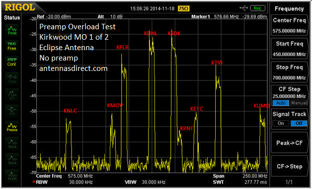

If KTBW is too strong for the preamp, switch to a preamp that resists overload better, as ADTech and Tower Guy suggested. ADTech did some preamp tests in a strong signal area that show the Winegard Chromstar UHF preamp overloads easily which harms the weak signals:
A Building Can Ruin Your Whole Day!
http://forum.tvfool.com/showthread.php?p=50328
It looks like with the preamp about half the signals were damaged beyond recovery. The weakest signals are the first to go when you have overload.
