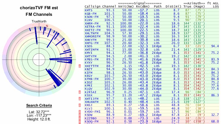

You have some strong FM signals that might interfere with your reception of TV signals. KHTS FM at -17.7 dBm is 13.6 dB stronger than your strongest TV signal KSWB, and it is 24.3 dB stronger than KGTV your weakest desired signal. You probably should insert an FM filter in the coax between the output of the UVSJ and the tuner. If you need a preamp it might have an internal FM filter that would do the job.
