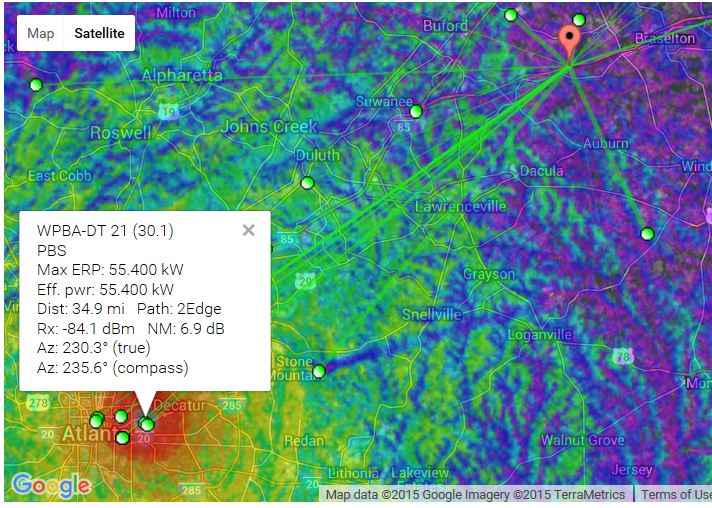

WPBA PBS real channel 21, virtual channel 30.1 is about 50 dB weaker than your strongest signal. Its signal path is listed as 2Edge, which means that the terrain will interfere with the signal on its way to your location. Your report shows that WPBA has co-channel interference from WHNS also on channel 21.
Your location is on the fringe of coverage for WPBA:
And there is terrain that blocks the signal:

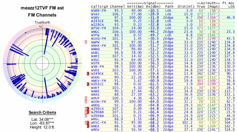

In addition to those problems, you have a very strong local FM signal WSBB-FM on 95.5 MHz with a strength of -10.5 dBm which might cause a problem for your preamp. See attachment 3.
