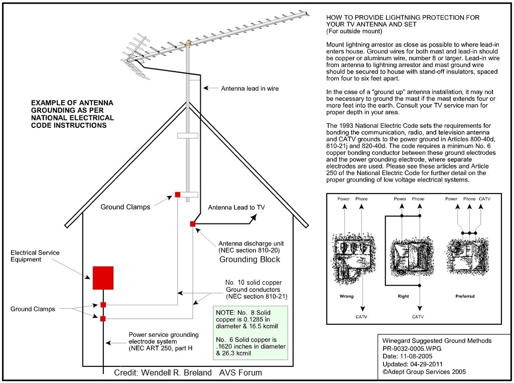

I will have to look into the whole grounding part of this. How does that work for a pad based/installed pole? I see by the diagram that the mast is grounded from a clamp mounted around(?) the mast pole so does that mean it would just be run down through a clamp on the in-ground pole? Of course I'm not even sure where/what the "power service grounding electrode system" is. But yes I figured it would be important, especially down here.... Is there a link to more grounding instructions on the site that I'm not seeing atm?
Interesting question in the gray area between the usual two ways. The diagram shows that the grounding block and the mast should be grounded separately to the house electrical system ground. The other way it is done is to connect the coax grounding block to the house electrical system ground and connect the mast to a grounding rod below the mast. In the second case the code says that the grounding rod for the mast must be connected ("bonded") to the house electrical system ground with number 6 gauge copper wire, which is very expensive. The reason given is to eliminate any difference in potential between the house electrical system ground and the mast grounding rod.
I'm not certain which category your ground mounted mast falls in, but I would pick the less expensive way. Since you have a lot of storms in your part of the country, you might want to consult an electrician. The person who has the final say about an electrical installation is the local electrical inspector, who the code calls the AHJ, Authority Having Jurisdiction. You might not want to get the inspector involved because some are more friendly than others. A local electrician can tell you more.
