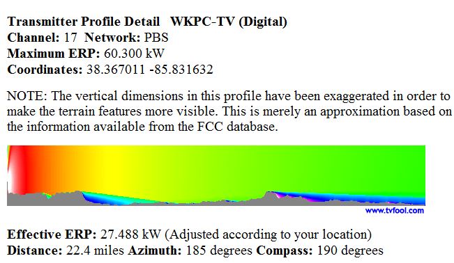

One local PBS station WKPC PBS KET (channel 15 or 17 from Louisville, KY) will work some of the time but not at all dependable. During a channel search the TV locates the WKPC station with 3 of it’s 6 sub channels only.
I only see a main and two sub channels, but PBS is known to change the lineup.
http://www.rabbitears.info/market.ph...&callsign=wkpc

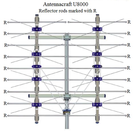

Is there a simple way for me to determine if the U8000 is modified to make it bi-directional as I had the antennas installed by a local electrician about 4 years ago and I simply do not know.
In your previous thread there was a discussion about removing the reflector to make the antenna bi-directional to receive signals from the north and the south. I don't know whether you did that or not. You also considered aiming the unmodified antenna north for the weaker signals while receiving the stronger from Louisville from the back. The third alternative was to just aim south for Louisville, IIRC.
Moving U8000 reflector bars vertically

The reason why I'm asking is because the best reception results are when the unmodified antenna is aimed directly at the transmitter.

And look at what the WKPC signal has to get above on its way to you:

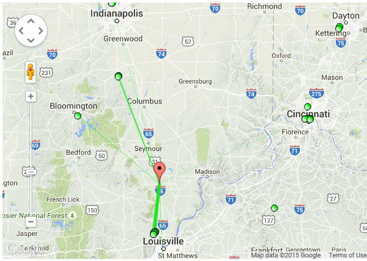

I don’t know the exact direction the antennas are aimed until I get on the roof to check although they are generally South and a few degrees to the West I think.
If you don't have a pocket compass to aim your antenna to the magnetic azimuth, you can use the green signal lines from the interactive map to pick a landmark for aim. You can move the cursor to the antenna location:

Sorry for the delay in responding. Ok, the Winegard YA 1713 Prostar 1000 10 EI, HI band VHF antenna (on top of pole) is currently aimed at about 157 degrees. The Antennacraft U8000 8-bay UHF antenna is difficult to measure the aiming direction although it is about 170 degrees. After being mounted for four years they may have moved some and may need to be re-aimed. The two antennas are combined with a UVSJ device. Yes the U8000 was modified to make it bi-directional by removing the reflector rods. The main difference in reception now compared to the past is that I am not getting the local PBS on a dependable basis and would like to fix that if possible.

OK, Dennis. I did another analysis with the idea of improving your reception of WKPC PBS.
1. If you look at the terrain profile in post #6 for WKPC you will see the red signal line just grazes the surface for the last 4 or 5 miles at the right end before it reaches you. It seems likely that trees have grown taller along that path. One of the ways to compensate for that would be to raise your antenna higher. Maybe you can put the UHF antenna on the top. If that is impossible, there are other things to try.
2. The antenna aim is critical for a high gain antenna because it has a narrow beamwidth. It must be aimed at 185 degrees in reference to true north by the green signals lines, or 190 degrees magnetic by a pocket compass, not a smart phone compass.
3. When you removed the reflector rods from the U8000 to make it bi-directional for Indy and Louisville, you lost some antenna gain. If you are willing to give up Indy, you can replace the U8000 with an Antennas Direct DB8E with both panels aimed at Louisville. This will give you more gain for Louisville by adding back a reflector, and because the DB8E is designed to have more gain at the low end of the UHF band where channel 17 for PBS is located. The gain for bowtie antennas is usually lower at the low end of the UHF band. If Indy is still important, you could have a separate antenna just for it.
