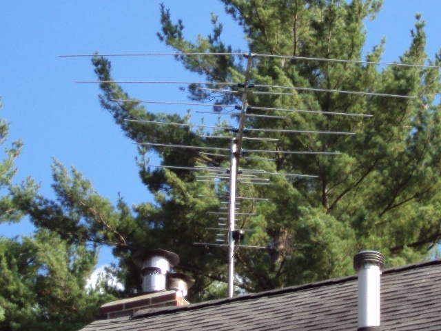

pix42 from ground
pix43 from N.E looking S.W.
pix44 holding camera as high as possible, yes the antenna is level.
pix45 from roof line showing distance to trees. paces off to approx 75 feet to tree vertical line.

Thanks for the photos and another test without the preamp, giving you just WMUR.
It's the TREES! The signals can't get through the trees. See attachment 1.
And most of them look like evergreens, so they are in the way all year, unlike deciduous that lose their leaves in the fall.
Heed ADTech's advice about trees:
http://forum.tvfool.com/showpost.php...90&postcount=3
http://forum.tvfool.com/showpost.php...26&postcount=2
I see a lot of trees in your area. See attachment 2.
I think your tree problem is worse than Kevin's:

I see a trifecta of problems. The antenna is aimed point-blank at:
Trees
Power lines
Power transformer
I do not see a viable solution.
