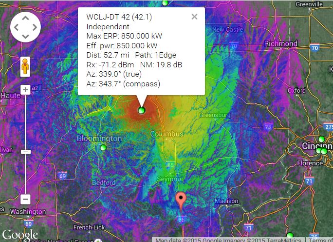

You are on the fringe of coverage for WCLJ:
