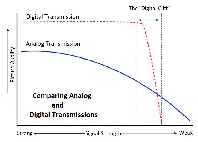

At least with analog tv, you could watch a show even if it was snowy and faded-out.
Right, there is no "Digital Cliff" with analog. With digital it's all or nothing.
