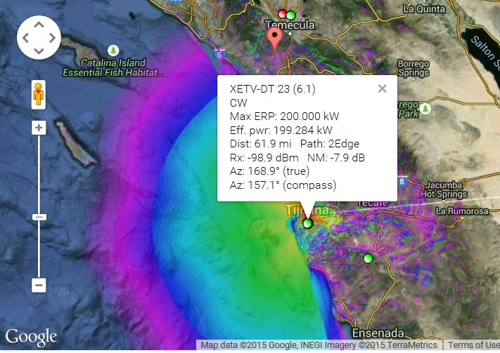

channel 6.1 XETV CW, (received sporadically)
It doesn't help your reception that KVMD is also transmitting on the same channel, which is considered co-channel interference.
And it doesn't help that the signal encounters rough terrain on its way to your antenna, which is why it is called a 2Edge path.

And it doesn't help that the signal barely makes it to your location:
