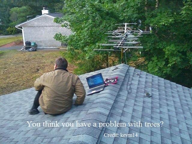

Kevin couldn't get the signals he wanted through the trees with his antenna aimed at the correct azimuth as you see in this photo. But when he aimed the antenna to the left where he is looking, he received some signals that came around the trees by diffraction.
http://www.avsforum.com/forum/25-hdt...l#post17280909
We tried clocking the antenna at as many discrete positions as we had time for, with the rapidly fading light last night. We let Media Center run through the signal strength loop each time we moved the antenna. The best overall reception seemed to be pointing at the only real open spot out of my neighborhood, or about 300°. As a refresher I was expecting to receive the strong RI stations @ 41° and the weaker Boston stations at 28-29° while pointed at ~32°. Well, how about 300?
http://www.avsforum.com/forum/25-hdt...l#post17297708
Cut down two trees and aggressively limbed the big white pine. I played the aim-game again with the laptop on the roof. I ended up at about 50 degrees which is almost exactly where the old antenna was aimed. Seems like the best overall trade off. I get a Boston CBS, ABC and FOX. And I get the off axis RI CW and RI ION. Boston 38 is intermittent but all of this is better than the 300 degree aim I said I was using earlier.

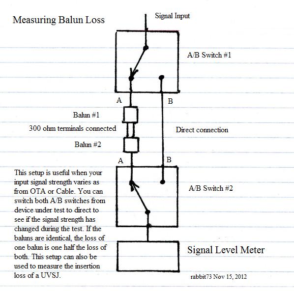

Thanks for the photos Mike. I appreciate the trouble you went to and have a better understanding of your problem. The trees are so close; I thought they would be further away.
Yes, the antenna uses a Winegard TV-2900 balun right now. I'm aware there are many other choices, but I'm not sure which ones would be better. Baring buying a bunch at random and trying them, I'm still limited at the moment in dropping the mast to try balun after balun. That's very hard on my muscles, as I'm 56 years old and have had neck and back surgery. That bringing the mast down issue will change once I get the swivel hinge made and taller mast installed. Then again, the taller mast might be enough to solve the issue.
Yes, that would be very inconvenient, no matter what your age. You could test balun loss before connecting it to the antenna with an A/B switch to make a rapid comparison with the CH 12 OTA signal. A DIY half-wave coaxial balun would have the lowest loss.
Your photos are quite wide. They make all posts wide on this page. I use 125% to read the text and 75% to look at the photos. Do you have a way to resize a little smaller? I try to limit mine to about 800 pixels wide. If not, I could resize for you.

I've resized the photos. Thanks for the schematic of the balun "testing machine".

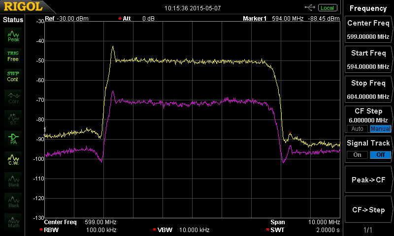

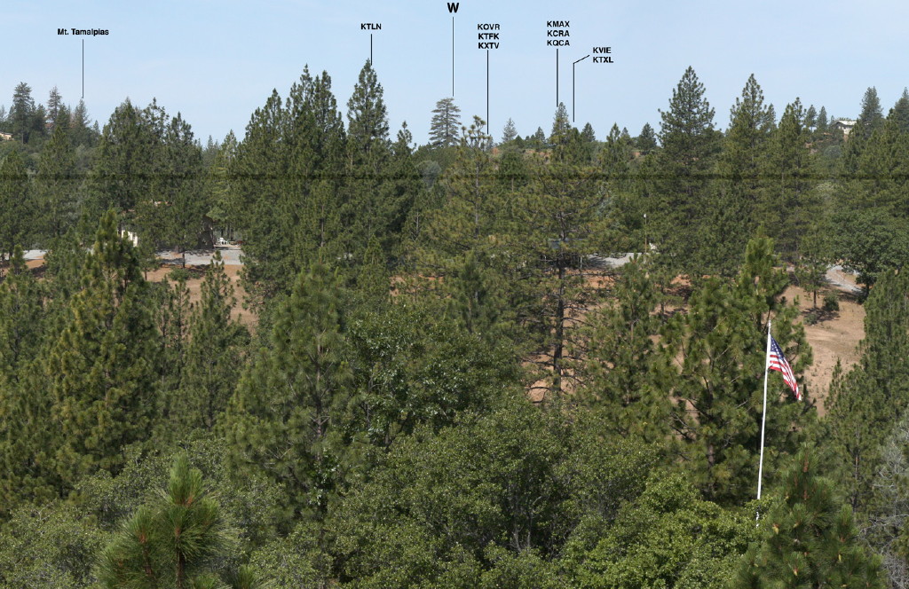

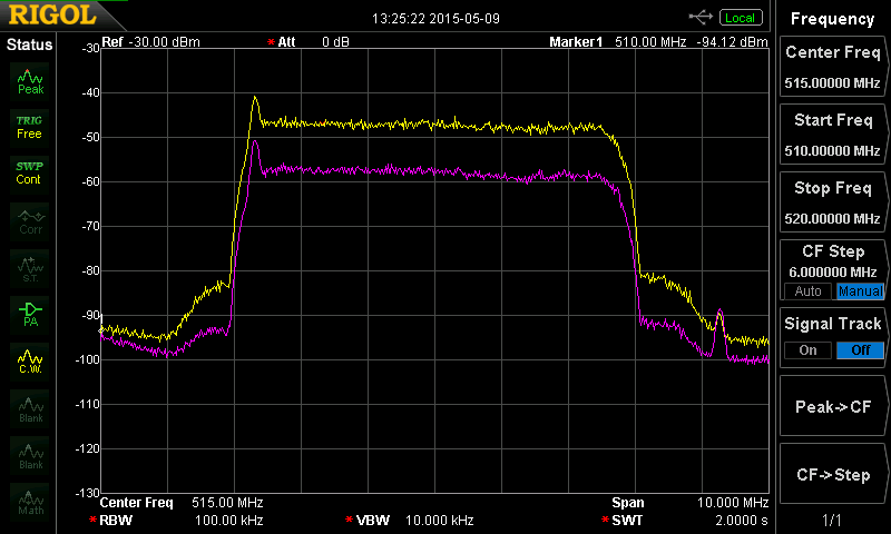

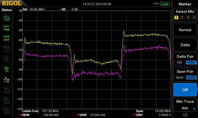

I have a couple of examples of vegetation affecting DTV signal strengths. The spectrum analyzer displays in this post show the difference between my antennas with the tower fully cranked up at 71' and fully cranked down at 36'. The yellow trace is tower up and the magenta trace is tower down. One image is VHF and the other three are spaced across UHF.
Attached is a picture taken from just below the UHF antennas at 69' looking west towards my local stations. (Camera was mounted on the mast and the tower was cranked up.) There is a clear shot to the 2nd edge that the signals pass over. There is vegetation on that hill. When the tower is cranked down much of the foreground vegetation blocks the view to the hill. There is as much as 20dB attenuation from the vegetation. UHF is generally affected more than VHF. Even though the signals look strong enough to receive, only 2 out of 9 stations will decode with the antennas lowered and their SNRs are very low due to severe multipath.
Getting the antennas above the vegetation is the difference between useable OTA and no reception.

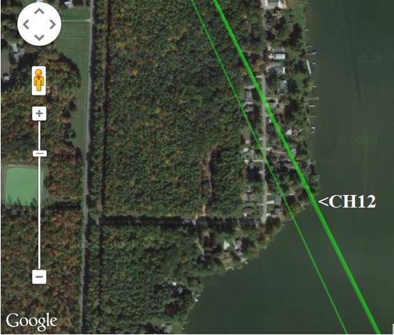

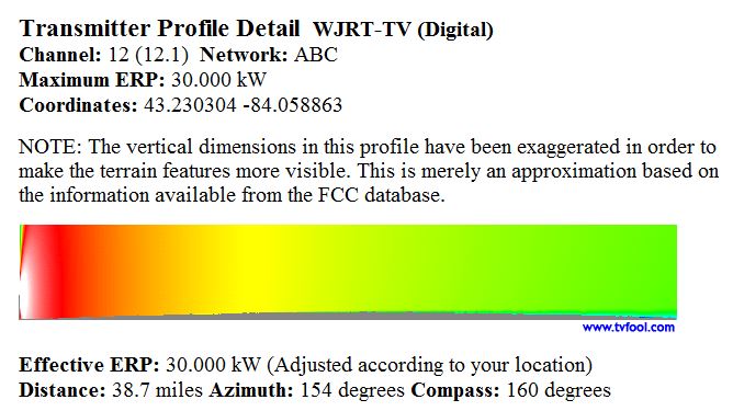

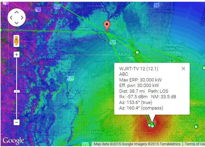

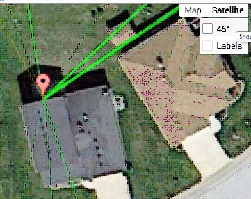

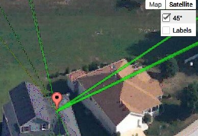

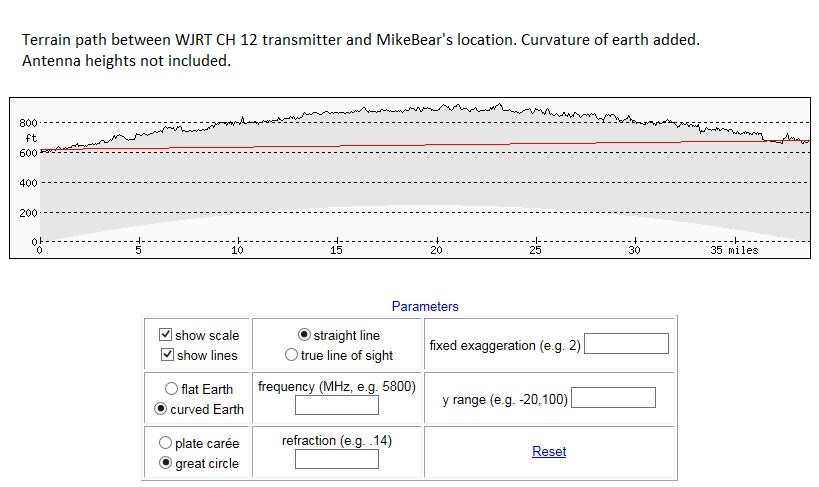

In order to better understand your situation, I looked at some aerial photos of your area and the channel 12 signal has to cross your neighbor's roof and also two other houses. I also did some terrain profiles for the signal path from the CH 12 transmitter to your location. The transmitter is at the left end and your location is at the right.
http://www.tvfool.com/index.php?opti...id=15&Itemid=1
The color code indicates signal strength.
- White is extremely strong. Beware of signal overload on amps.
- Red-yellow-green are all quite strong. You can expect reasonable coverage with an indoor antenna.
- Cyan is where it's advisable to move the antenna up to the second floor or attic.
- Blue is where it's probably necessary to install a good antenna on the roof.
- Purple is quite weak and you really have to work at it for any chance of reception.
If you look carefully you can see it's starting to turn cyan. The same colors are used for the coverage map.

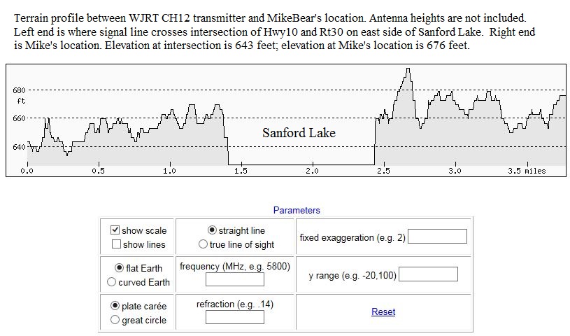

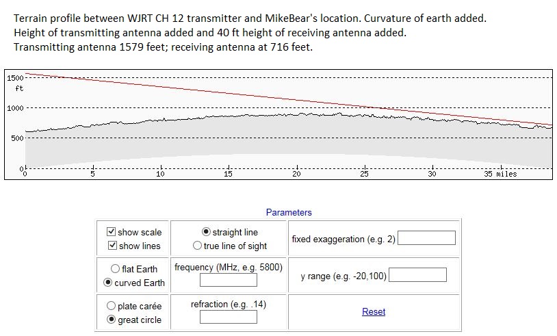

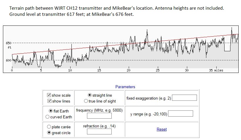

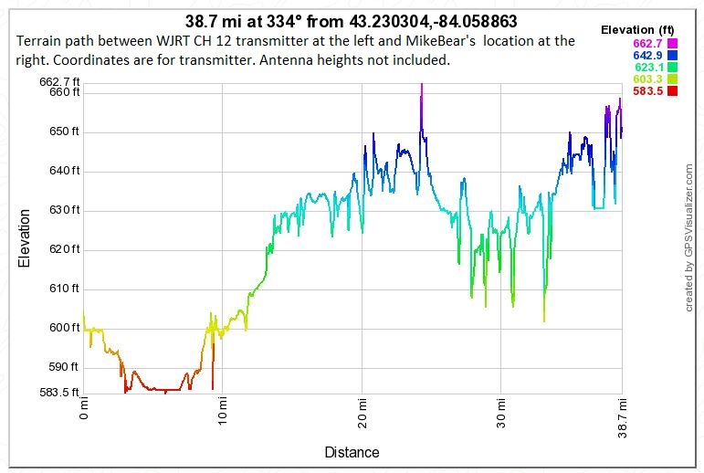

Using another terrain profile system:

Hummm, so as I suspected, my VHF antenna for WJRT-12 is just BARELY at the very bottom of the 'wave' of signal from this transmitter. It's a wonder at the moment that I get it as well as I do most of the time!
I think that extra 10-12 feet of higher mast, might really be the thing that makes the biggest difference. Short of chopping down, or thinning out some trees.
Thanks for your work so far on this Rabbit, I REALLY appreciate it! I'm sure it'll also help others reading it to understand a bit more about their antenna situations.

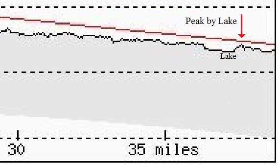

In the last profile I saw a peak by the lake and wanted to do a closer profile.
WJRT transmitter site:

The "Lake" (and I use the word loosely) is the Tittabawassee (yes, it's an American indian word) river, that's dammed up on one end with a hydroelectric dam that's been there since 1925. The dam is on the left side of your terrain pic. The river drops towards it to build up head-pressure.
Us-10 expressway crosses the lake right there, just after the supposed "peak" you show (it flows right to left). There is an outjutting (into the lake) of land there, with a subdivision of very tightly packed houses. The signal passes over that outjutting, and then is clear over the water again all the way to my subdivision.
There is no peak there that I am aware of, or that can be seen by the naked eye, certainly not to the height of what that terrain profile shows. I can't even imagine what that is showing in this case at all. There's just no chance that there's any sort of high ridge on that side of the expressway that's invisible, so I'm at a total loss here as to why it shows one.
Old 26-Aug-2015, 1:15 AM   #36
I think the vertical scale exaggeration is misleading you.
The average peaks on your side are at 680 feet; the tall one is only 15 feet more than that average. It would be difficult to see that difference when standing there, but that peak does project into the signal path, and it can't be ignored.
That extra 15 feet probably isn't any more than the height of the trees.
Also, the resolution of the measurement data probably isn't that precise.
Sorry, didn't mean to mislead you, I was just curious to see what a close-up profile would show.

The channel 12 signal reaches landfall on the west side of the "Lake" far above US10, because it crosses at an angle, not straight across. The terrain profile follows the green signal line; it is not an east to west profile.

The channel 12 signal reaches landfall on the west side of the "Lake" far above US10.
Ok, in that subdivision as you drive along the road ( starting at the landfall area of the Wjrt signal), that parallels the lake (UP in your pic) you go UP a hill there that's just past the upper edge of the map photo. I would have to say that hill is at least 15' higher than the normal ground level on the majority of that area.
You are certainly making me see my whole area in a different way now, lol. So much you never really "notice", even though you see it almost every day...
