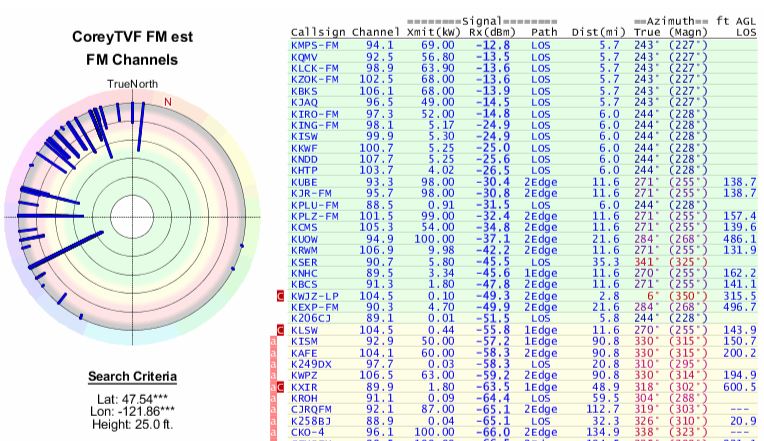

You have some strong local FM signals that might interfere with TV reception. Insert an FM filter/trap in the coax line. See attachment.
http://www.mcmelectronics.com/produc...804247%2Cd.cGU
You can also use a HLSJ instead of an FM trap. It blocks everything below TV CH 7 including the FM band. Use high and common ports.
