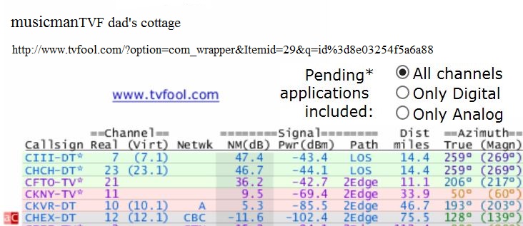

I redid my TVFool report using my exact address. It is in a rural area and not close to any city. There are tall trees all around my cottage. Here are the results :
http://www.tvfool.com/?option=com_wr...8e03254f5a6a88

Thanks for the new report for dad's cottage. It's probably more accurate than the generic Gravenhurst report, even though it is only resolved to street level and not an exact address or coordinates. Unfortunately, the signals didn't look as good in the new report, but they got better when I remembered to click on pending.

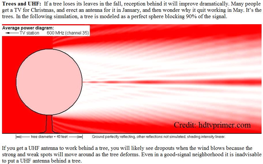

The trees are bad news; see attachment 1.

If you can find a fairly clear path thru the trees, you have a good chance for CIII-DT on real channel 7 and CHCH-DT on real channel 23, and maybe even CFTO even though it's now listed as weaker. Real channel 7 is a VHF-High channel which is why you need a VHF/UHF combo antenna.
