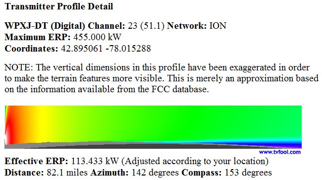

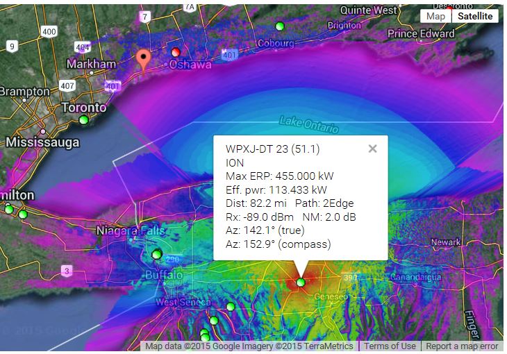

ION isn't going to be easy. The curvature of the earth starts to interfere with TV signals at about 70 miles. If you look at the terrain profile by clicking on its callsign in your TVFOOL report, you will see a black arc at the bottom of the profile; that's the earth. And you will also see that only a small portion of the ERP is sent in your direction:
and if you look at the coverage map, you will see that the signal barely makes it to your location:

I used to get ION when I first set up the antenna. To do so I had to point the antenna to about 160 degrees, but then I also got all the Buffalo stations just fine. But nothing from Toronto. So I rotated it to catch Toronto and then of course ION disappeared.
I should also note that I can get some of the other NY stations that are just as "deep" into the hinterland as ION right now. So I'm relatively confident I can get ION again, at least in the summer, with an antenna pointed in that direction. If I lose it in the winter, c'est la vie.
Following your logic I'll stick with the array. The only channel that really requires that is Fox, and that one is kinda marginal right now.

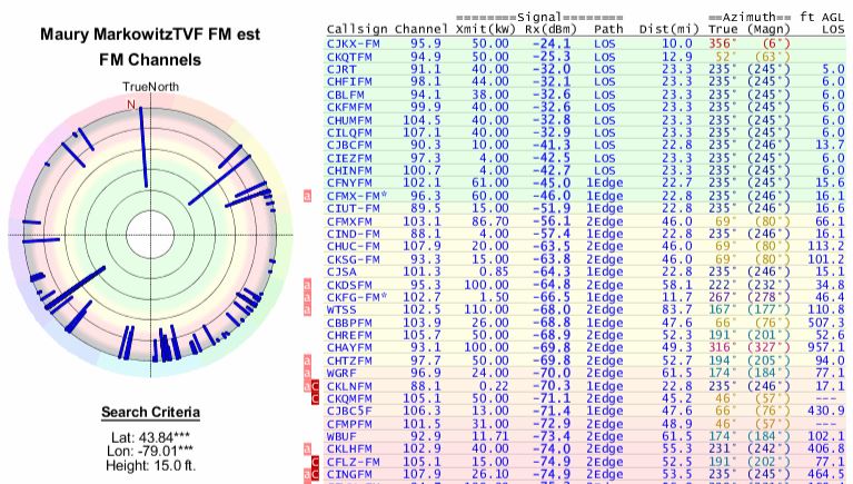

I also did an FM fool report based on your estimated location that shows some strong FM signals that could be attenuated by an FM filter to prevent interference with TV reception. See attachment. Roger1818 of DHC told me that the data for Canadian FM stations isn't up to date at FMFOOL.

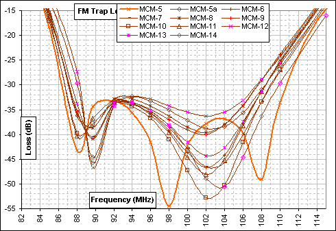

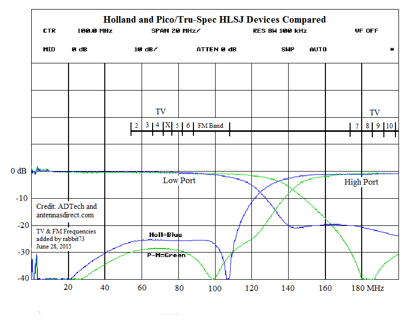

Any suggestions on a filter?
All FM filters are not equal. If I'm using a preamp with an FM filter, I have to accept its attenuation curve. If I pick a filter for a system without a preamp, or a system that needs even more attenuation than provided by the preamp FM filter, I select a filter that attenuates the frequencies of the strongest FM signals. A HLSJ makes an effective FM filter because it attenuates everything below channel 7 including the FM band. Some filter curves in the attachments.
Attachment 1: Antennas Direct FM trap vs Radio Shack 15-577. Notice that the AD does better at the low end of the FM band than at the high end. The RS attenuates better at the high end, but doesn't at the low 88 MHz end to allow reception of TV CH 6.
Attachment 2: The MCM FM trap does well across the whole FM band.

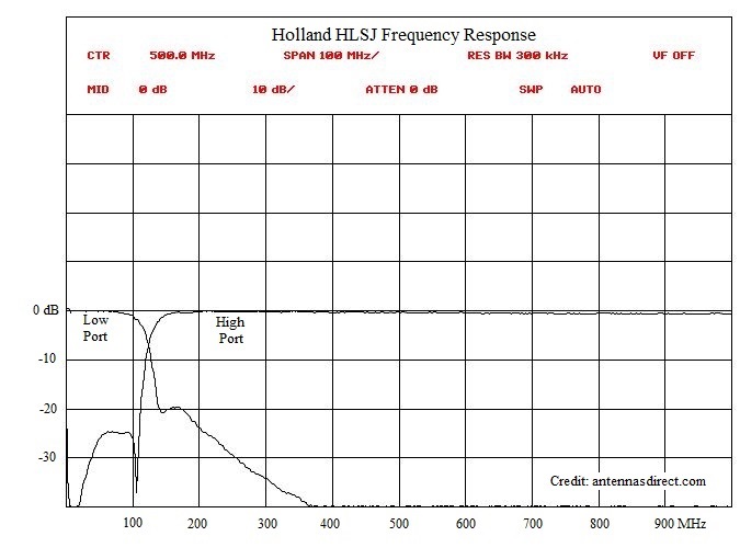

Attachment 3: A HLSJ used as an FM filter.
Attachment 4: I was concerned that a HLSJ might affect reception of UHF signals. ADTech did this test that shows the attenuation of the Holland HLSJ is of no concern for UHF signals.
If FMFOOL is correct, your two strongest signals are CJKX-FM on 95.9 MHz at -24.1 dBm and CKQT-FM on 94.9 MHz at -25.3 dBm.
Your strongest TV signal is CICA-DT at -39.6 dBm, which is 15.5 dB weaker than CJKX-FM.
FM can interfere with TV signals in two ways: fundamental overload, even affecting UHF if the FM signals are very much stronger (not likely in your case), or 2nd harmonic (2x its frequency) of FM signal falling on VHF-High channel frequency.
https://en.wikipedia.org/wiki/North_...on_frequencies
