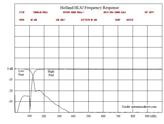

I do have a minor concern about HLSJs. If you put one in front of a UHF amp, will the high side, which is a high pass filter, introduce any significant insertion loss for the high end of UHF? It was never really designed for that task, and the specs of some say passes 170 to 600 MHz.

I tested the Pico and the Holland HLSJ units several years back. The specs are simply incomplete, there's negligible insertion loss up in UHF land. I'll see if I can dig up either the old data and/or the samples I had from back then and rerun them using my much newer and more accurate gear.
Google to the rescue. See this post: http://www.digitalhome.ca/forum/81-o...ml#post1265531
Holland HLSJ measured, Pico similar.
Thanks for the data. I'm feeling better already.
