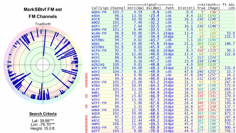

You have some strong local FM signals that might cause interference to TV reception. The FM filter in the preamp should take care of it. If not, you can add an FM filter. See attachment.
