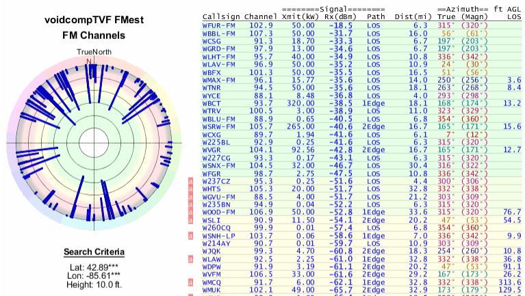

You have some strong FM signals. In addition to the UVSJ test, you should try an FM filter. See attachment.

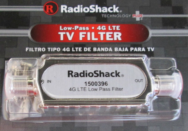

A 4G filter would be worth a test; the interference might be coming from above channel 51.
https://en.wikipedia.org/wiki/4G-LTE_filter
