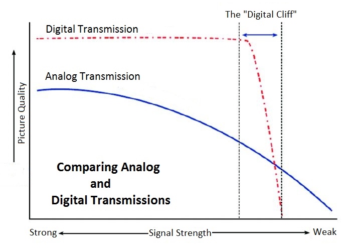

With tweaking of the aim of the Y7 10 13 and a presumed signal quality improvement
Tweaking aim while monitoring signal quality (SNR and errors) is the best way to do it. The technique works best and is most sensitive when the signal is weak and close to the "Digital Cliff."
Aiming an Antenna for Best Signal Quality
http://forum.tvfool.com/showpost.php...19&postcount=7
