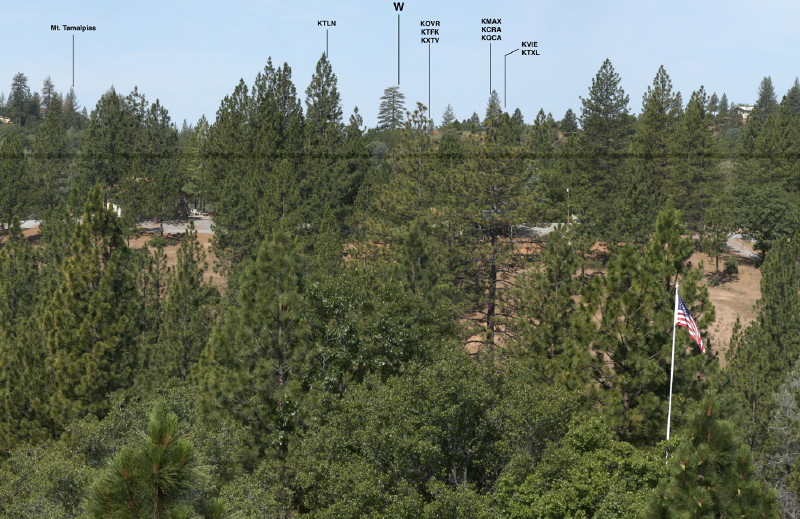

His trees in attachment.
The WHO signal (which is already weak by the time it gets to you) can be damaged by trees, multipath, primary overload from strong TV signals, primary overload from FM signals, a 2Edge path, and electrical interference noise on VHF.
