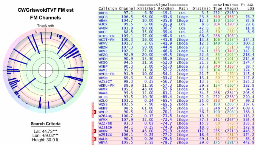

You probably will not be able to use a preamp for these two channels, because they are strong enough to cause overload. An FM trap might be required. WBFB FM 0n 97.1, 3.5 miles away, has a strength of -19.1 dBm that might interfere with VHF TV reception. See the Attachment.
