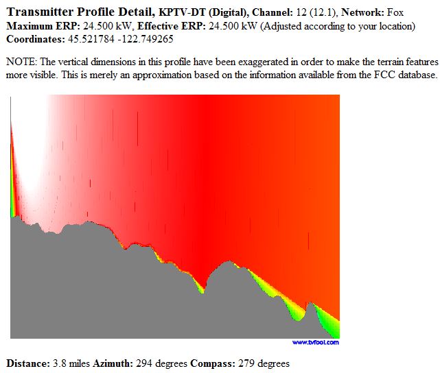

You should get down to Fox and maybe even down to KPDX real channel 30 if you are lucky and if the C2V has a clear shot to 277° magnetic.
If the bay windows have lowE glass, that can block signals.
Trees really mess with UHF (real channels 14-51) signals. See attachment 2
Unfortunately, despite how close I am to the towers, I am on the downhill slope AWAY from them, and I think that is where my problem is.

I think the trees are messing with your signals, sort of like looking through lace or gauze.

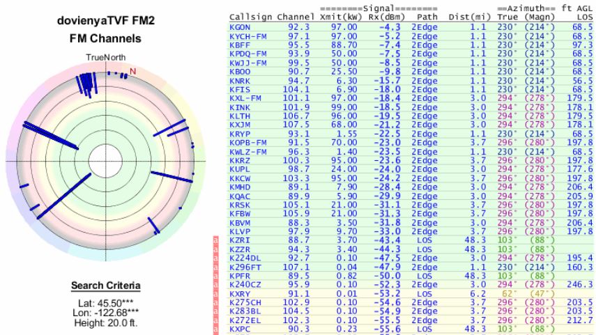

I then wondered about strong local FM signals that might cause interference to your TV reception, especially real channels 8, 10, and 12. I did an FM FOOL report using your zip code, and the strongest FM signal was +7.7 dBm, at 0.4 mi away!
I then did an FM FOOL report based on your estimated location derived from your tvfool report which gave -4.3 dBm at 1.1 mi; still extremely strong. I think an FM trap/filter, or 2 in series, between the antenna and the tuner would help, and they are not very expensive.
It seemed to help another Tivo user:
http://archive2.tivocommunity.com/ti...d.php?t=270549

I went to the local hardware store today after seeing your response. Sadly, no FM trap, despite them having had about 30 different coax ends for self-install cabling, and quite a few splitters. If I don't find one local in the next day or so, I'll be ordering online. Fingers crossed that that may help out, and I thank you for the suggestion!

Well, an FM trap does appear to have helped a little, in that I am able to get a few more channels to a viewable state in a single position of the antenna. A second FM trap in line seems to only reduce the signal strength a little across the board, with no other noticeable effects.

In the attachment you can see the difference between the Antennas Direct and the older Radio Shack FM filter. The AD filter attenuates the FM signals at the low end near 88 MHz and TV CH 6, but doesn't remove all the FM signals at the high end near 108 MHz. The RS filter protects CH 6 for people that need to receive it, and does a better job of removing the FM signals at the high end of the FM band near 108 MHz.
