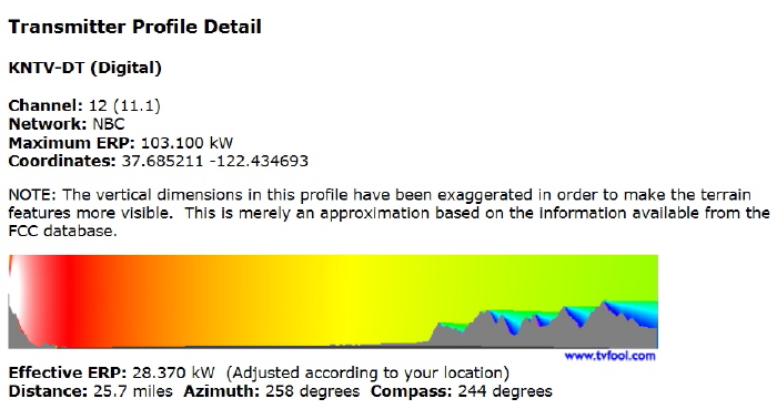

This is what the KNTV terrain profile looks like. Notice that the ERP is only 28 kW out of 103 in your direction:
And this is for KQED:
The signals from VHF real channels 7 and 12 have a better chance of diffracting over the peaks of the hills than the UHF channels. It might help if you tilted the front of the antenna up a little. The 7698 doesn't have a tilt adjustment, like the UHF only 91XG, so it would be a custom modification.
I tried different heights using an estimate of your location. It helped a little, but not a lot. Your 2Edge signals aren't likely to be 100% reliable, but I think your chances are good if you don't have trees or buildings in the path between your antenna and the hill peaks.

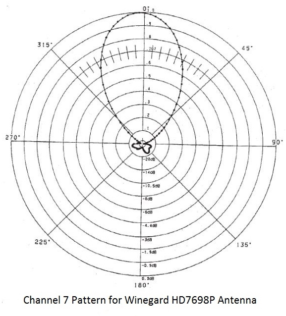

Interesting question. There is the straight forward practical part, that concerns signal strength. How critical the aim depends upon the horizontal beamwidth of the antenna that is given in terms of the halfpower (3 dB down, or 0.707 voltage) points (HPBW). Generally, the higher the gain, the narrower the beamwidth, which is an inherent trade-off, because energy cannot be created or destroyed, only converted. Or, as ADTech likes to say TINSTAAFL
http://www.antenna-theory.com/basics/radPatDefs.php
http://www.cisco.com/c/en/us/support...vs-direct.html
Looking at the beamwidth charts for the 7698, I see different answers, but think the chart at solid signal is wrong:
http://www.solidsignal.com/pview.asp?p=hd7698p
Click on specifications, and scroll down to the chart below Step 3
And also wrong here:
http://www.winegarddirect.com/viewit...HD7698P)&post=
The correct Winegard chart is here:
http://www.winegard.com/kbase/uploads/HD7698P.pdf
The more esoteric part concerns signal quality. I have found that if I make the initial aim based on signal strength, and then monitor signal quality based on SNR and errors, I am able to optimize aim. The greatest signal strength and the best signal quality aren't always at the same azimuth. Go for signal quality. My Sony TV has a diagnostics screen that gives signal strength, SNR, and errors.

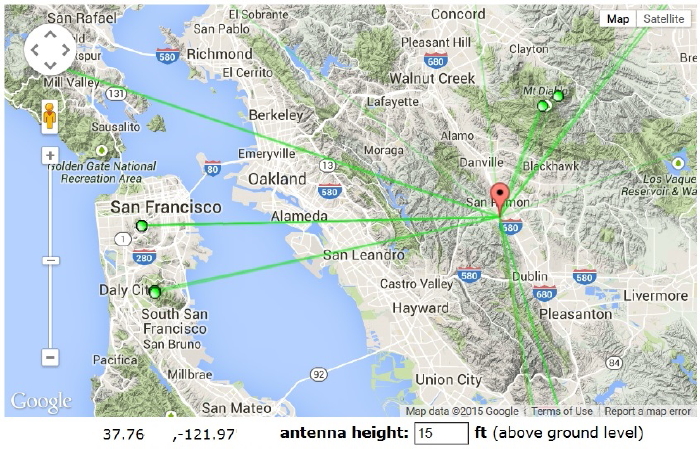

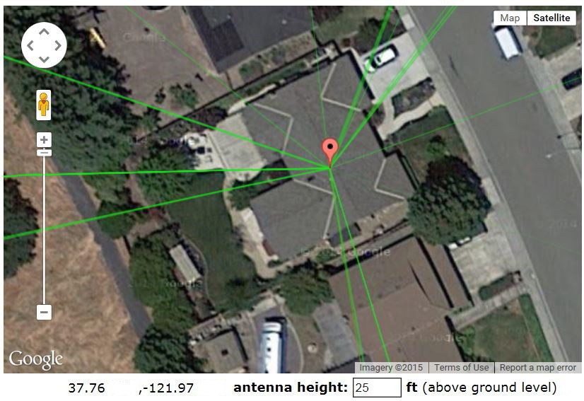

You can use the green signal lines from the tvfool interactive map feature to help you aim. You can move the teardrop cursor to the exact antenna location. Then pick a landmark.

Here are two views of broadcasts of ABC, NBC, CBS channels. In each photo the degree azimuth is about the center of the photo and is the magnetic bearing.
View towards 244 degrees (channels 7, 12, 29, etc.) - appears to be completely blocked by large trees. I am assuming this won't work.
View towards 24 degrees (channels 10, 25, 35) -- The hill involved is visible in the center.
So, it appears to me that I may have more success with the 24 degree azimuth.
Any opinion about the trees causing problems for the 244 and 24 degree azimuths? Unless success seems highly unlikely, I'll go ahead with the Winegard HD7698P and try to catch some channels.
