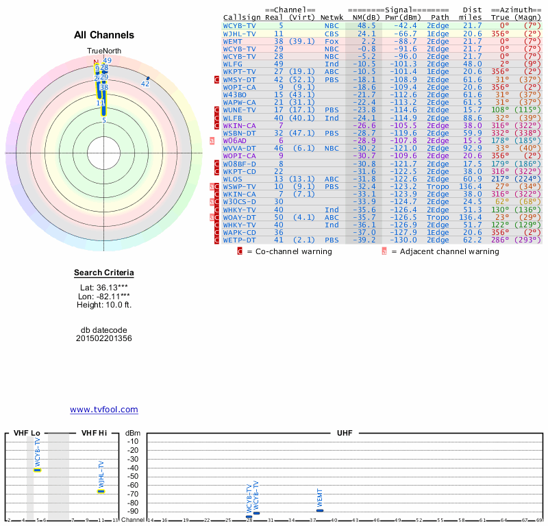

hey everyone, I am new to the forum and very new to ota antennas. I need some help deciding on which antenna I need to pick up as many channels as I possibly can. I would like to keep it as simple as possible but I also want the best option that would work for my situation. i'm just trying to see how much it would cost and how difficult it would be to be able to get rid of the satellite. I have included my tvfool analysis and I hope you guys can help me out. thanks in advance for the help.

Greetings,
I know your post is over a month old, however if you are still interested in help can you post updated TVfool plots of 25', 50', 75' and 100'?
Signal access at 10' isn't good. Perhaps it improves with elevation.
