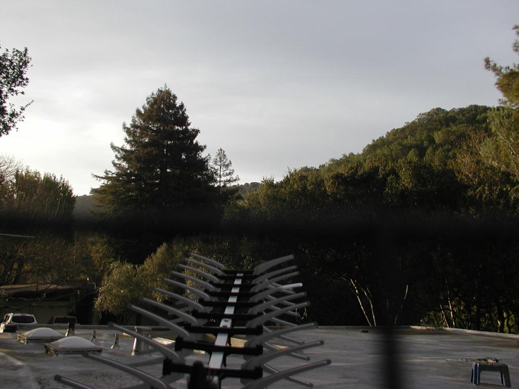

Here is an update
I deployed the Antennas Direct 91XG + AntennaCraft Y10713 at temporary locations
on the roof. Boresight 91XG at hill ridge towards Sutro Tower.
Reception improved compared to the old RS yagi.
There are fewer intermittant dropouts. I can receive all of my must have channels when
conditions are good. KTVU (RF 44) remains a challenge. Most of the remaining dropsouts
on KTVU.
To make more progress, I need a better way to measure signal quality.
Accessing the Samsung TV Signal Strength screen is awkward.
I appreciate the wealth of information offered in this forum.

I am now using a SiliconDust HDTC-2US as a diagnostic tool.
91XG + 50ft RG6 + HDTC-2US
RF Strength Strength Signal Quality
29 80 90
43 73 78
44 75 67-78
45 81 85
91XG + RCA TVPRAMP1R + 100ft RG6 + HDTC-2US
29 100 98
43 100 85
44 100 73-81
45 100 90
I still experience intermittent reception
on KTVU (RF44). The stations on RF43, RF44 and RF45 come from Sutro Tower.
Could multipath interference still be an issue dispite deploying
the Antennas Direct 91XG? The RF44 flutuating signal quality looks suspious.
Signal quality on R29,RF43 and RF45 are stable.
Aiming between trees to hill crest limits my roof antenna placement.
Once I get a better mast, I will resume adjusting high. Right now using the
saw horse and pvc pole.
If it is multipath interference, I read stacking a 2nd 91XG may help.
I don't expect perfect reception. Just fewer intermittent events.
I agree using a chainsaw on the near trees would help
ckwsp101_tv is offline   Reply With Quote

Old 17-Mar-2015, 3:09 AM   #13
ckwsp101_tv
Join Date: Feb 2015
Posts: 40
GroundUrMast ,
Glad to know I'm going in the right direction.
It appears my sight line to Sutro Tower goes right through a Extenet Micro Cell tower along a public road. I have email to Extenet about my TV reception concerns.
The HDTC-2US reports unlabeled "auto" Signal Strength
of 70% on RF 58 , RF59, RF 60 and RF 61.
When I point the 91XG 15 degrees off line of Sutro
RF 44 Signal Quality improves.
But RF 29, RF 43 and RF 45 Signal Quality goes down
(left of redwood tree to ridge)
91XG + RCA TVPRAMP1R + 100ft RG6 + HRTC-2US
29 100 69-71
43 100 85
44 100 90
45 100 81
RF 44 channel specific interference? Even when coming from same tower it can happen
My best roof location can point left or right of the big redwood tree.
When I get a better mast I will try adjusting the antenna height. Will 6 inch increments
be a good starting place ? Maybe I will go back to pointing right of the redwood tree with height adjustment. I read the articles on stacking identical antennas to manage multipath
interference. That will be a last resort.
Once the above resolved, I need to deal with NBC RF 12 which is Signal Strength 87 and Signal Quality 60.
The Y10713 is really compact compared to my old 10 foot Radio Shack antenna.

spacing between the antennas.
On my SiliconDust HDTC-2US Signal Strength increased 2%. Signal Quality increased 6%?
During high wind event RF12 Signal Quality fluctuations went down.
With a single Y10713 on windy day Signal Quality fluctuation spread was 6% or greater.
The vertical stacked 2 Y10713 configuration tightened (reduced) Signal Quality fluctuation to 2%.
On rare occasions Symbol Quality is still lost with the stacked Y10713 configuration.
Still much improved over a single Y10713.
During the same high wind event RF44 Signal Quality fluctuation spread 8% or greater.
The Symbol Quality held up. So the picture looks ok. The 91XG also experiencing multipath interference.
Right now I'm the only house with an OTA array.

Old 4-Oct-2017, 1:31 AM   #19
ckwsp101_tv
Join Date: Feb 2015
Posts: 40
An update
I'm the only residence with multiple big antennas.
I had to educate the home owners association about my right to deploy an antenna array.
UHF channels still viewable.
Using latest SiliconDust firmware. The firmware update changed signal quality scale.
11.1 (RF 12) is still the challenging channel. Frequent reception failures compared
to 12 months ago. Stacked VHF antenna balun lead wires are breaking down.
Unplugging one VHF antenna drops signal quality by 10%.
I think stacking the VHF antennas is still a win.
RF 12 drops off reception cliff when signal quality drops below 50%
Conditions have changed for the worst of the last year.
Tuner Channel SS SNQ
0 7 ss=96 snq=90
1 7 ss=96 snq=90
0 12 ss=75 snq=58
1 12 ss=76 snq=59
0 49 ss=78 snq=80
1 49 ss=78 snq=81
My plan is to replace the VHF baluns.
I read in another posting that quality external baluns are hard to source
Trim some near branches.
If that does not improve situation, I may look for a new location for the VHF
antenna stack. Keep the UHF antenna at current location on roof.
I'm lucky to receive alternate KNTVHD 11.3 (RF 49).
