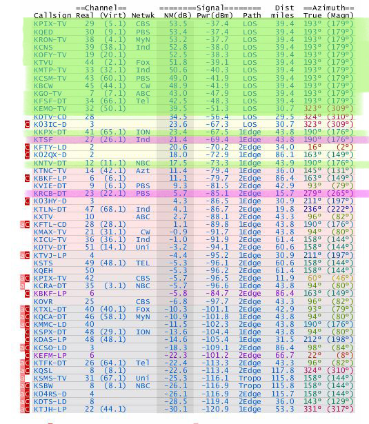

Greetings all and thanks ahead for any help.
Here is my report at 20ft.:
http://www.tvfool.com/?option=com_wr...d243e79fbc270b
I could go as high as 25' or so, but I will need to wall mount about 4 ft. down from the apex of the roof so I can aim between two of my neighbor's trees (179 magnetic)
I have green highlight on the image below for stations desired, the pink ones are optional:
Thanks - Sam

If you can aim between the trees at 179, then the UHF stations in that direction should be easy. The two VHF-high stations on your list are also at heading 179, KGO and KNTV. I'd think you will be able to pick up everything you have highlighted at 179/176 with a modest antenna, like the RCA ANT751 (ca $50). Unlikely this will pick up KEMO and KRCB though
What is the line-of-sight like aimed at KEMO? Another modest antenna (a second ANT751?) aimed at 309-310 should pick up those stations in that group. But you can't naively combine multiple antennas into a single wire. You could use an A/B switch and switch between antennas, or go fancy and connect separate tuners to your HTPC (a HomeRun HD, for example).
Getting KRCB will take something more. It is both off-axis and weak. You should be able to get it, but it will take a sensitive (large) UHF antenna pointed right at it, and no trees in the way.
Another possibility, if you want to put everything on a single wire coming down, is to use a DB8e antenna for UHF (ca $150), and separate cut-to-band antenna for KGO and KNTV, like the Antennacraft Y5713 (ca $30). Point one panel of the DB8e at 179 and one at 309 to get all your highlighted UHF stations 14-51 (except KRCB). Point the Y5713 at 179 to get 7 and 12. Then merge the two wires with a UVSJ combiner (ca $5). There is lots of signal in the air, so you should not need an amplifier.

I see now that there are already two PBS stations with a good signal, so I don't really need KRCB. And I can also do without KEMO for now.
I'll keep it simple at first - it will take me a few weeks to get around to installing, but I will report back then.
