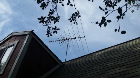

I live in the Sierra foothills about 50 miles east of Sacramento and at about El. 1900 ft with what I believe is within LOS of transmission towers on the valley flow also about 50 miles away. I have a barn with a finished upstairs and with an antenna already mounted on the roof. A photo of the antenna is attached.
My wife and I want to make use of this upstairs including the ability to watch TV. Rather than install another dish or stretch a cable to the barn, I looked to the easiest way out. I hooked up an HDTV, did a scan (this was during the day), and pulled in RC 21, 25, 9, 26, and 18. My wife (and maybe me, too) was hoping to get RC 35 (the local NBC station), I figured I needed a better antenna and started searching the 'net. This is where I found this site (thanks for what I have learned so far).

The bulk of these channels are located 229 to 231 degrees true azimuth which makes me believe the antenna is pointed in the correct direction.

Have you tried moving the antenna up or down, or side to side? I'd guess you are in a local null for RC 35, which goes away when the atmospheric conditions are right (ie at night). Look here http://www.hdtvprimer.com/antennas/siting.html for some insight about nulls.
The TVFR is just a simulation, and does not have the spatial resolution to pick up local nulls on the scale of the wavelength, if that's what you are experiencing.

You're right, if your antenna is not receiving a clean signal, an amplifier is not going to filter out the noise and interference... both are amplified right along with any desired signal. An amplifier is only intended to overcome loss in cable and splitters connected to the output of the amp. No amplifier 'pulls' signal in. Amplifiers are only capable of 'pushing' signal out. Unless you are going to drive some unusually long runs and split many ways, I see no need for amplification. There's plenty of signal power in the air according to the report you've posted.
Follow timgr's suggestions. Be open to adjusting aim and mounting height as well as location. While you're up there, carefully inspect the antenna, coax and connectors for signs of weathering, corrosion or other damage. Any moisture allowed to enter the coax will make it unreliable. Wet coax can affect just one channel if the conditions are just right. If water intrusion is suspected, a new cable and connectors are needed. Wet cable can never be trusted, and should be scrapped rather than salvaged.
