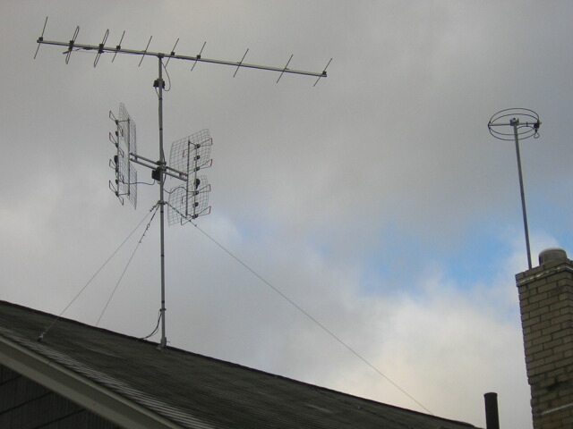

You can use a roof bracket and guy wires, or a tripod. Take a look at the mounts here - http://www.antennapartsoutlet.com/
My installation with a roof bracket and guy wires -
