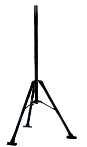

If that existing dish mount has support "legs" for a larger 18x24 dish, it's sturdy enough to install an extension pipe into it an raises the C2V up. Depending on the specific mount, you might easily get 5-8' of additional elevation which might clear the neighbor's rooftop.
Good idea; I didn't think of that.
Let's say that dish doesn't have "legs" is there a mount that could be used in its current location that would give it enough height there to alleviate any issues? Just wanting to consider all the possibilities.
A 5 ft tripod mount with a 10 ft mast might clear the roof.
VMP TR-60 60 Inch Roof Mount Tripod for Antenna Mast

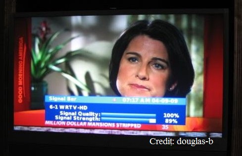

My next question is regarding aim. How would the antennas be able to be aimed precisely (particularly critical for the 91XG) because its not like that part of the roof is able to be walked around on like where it is located now.
Interesting question. The initial aim can be done by using the green signal lines (90 degree vertical map, not 45 degree bird's eye) shown on the satellite map. They are based on true north, so you can aim the antenna at a landmark on that line. You can also use a compass with the magnetic azimuth.
I have found that the best aim for an antenna is not always where you have the greatest signal strength. I was doing some experiments using an Apex DT502 converter box that has two signal bars; one for signal strength and one for signal quality. When I rotated my CM4221 UHF antenna slightly to the right, the signal strength went down very slightly, but the signal quality increased a large amount.
As you have already learned, what good is a strong signal if it also isn't a high quality signal with few or no errors?
You are now a member of the Antenna Measurements Club, because you passed, with flying colors, the initiation when you did the attenuator measurements. When you increased the attenuation, the SNR dropped down to below 15, and you saw an increase in uncorrected errors.
To make the final aim of an antenna, increase the attenuation until the SNR gets down to about 16, which is just above the "digital cliff." This is where the aim is most critical. Then rotate the antenna slightly each side of that aim to look for a increase in SNR, and a decrease in errors.
The see how well your 91XG is doing, try the attenuator test in its coax line between the amp and the input of the AC7. Add enough attenuation to bring the SNR down to 16 dB. This tells you how much "fade margin" you have at that location to deal with changes in signal strength.

If you put the tripod on the garage roof, I don't need to tell you not to put it in front of the 91XG, do I?
The tripod should be fastened to the roof by a roofer to reduce the chances of a leak. Better a leak on the garage roof than on the roof above the 2nd floor.

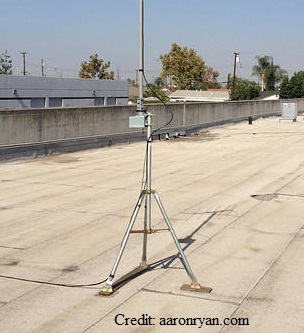

If you put a non penetrating roof mount on the garage roof to avoid fasteners through the roof, it would need to have adjustable pitch; most are welded at 90 degrees vertical. Also, you would need to put some weights on it.
https://www.google.com/search?q=non+...A&ved=0CDYQsAQ
As ADTech said, your garage roof is not flat.

You now have two choices:
1. eave mount and 5 ft mast for the C2V at the rear of the upper roof
OR
2. 5 ft tripod and 10 ft mast for the C2V on the garage roof
The 10 ft mast is inserted several ft into the top of the tripod mount
The 91XG is no longer involved because it is staying right where it is now.

I was mainly wanting to know if the 10 foot mast should be used if going with the eaves mount.
The eave mount is not sturdy enough for a 10 ft mast; 5 ft max for eave mount.
So, if the price is right, why not two, because I have another idea for you to try.
version in attachment 3 would be without rotor

That third attachment is a tripod with a mast inserted. You wanted to know what a tripod with a mast inserted would look like to show your wife. That is the closest image that I could find outside of attachment No. 2. Disregard the rotor. You don't need one for the C2V. The image just happed to have a rotor.
Sorry, I didn't mean to confuse you.
