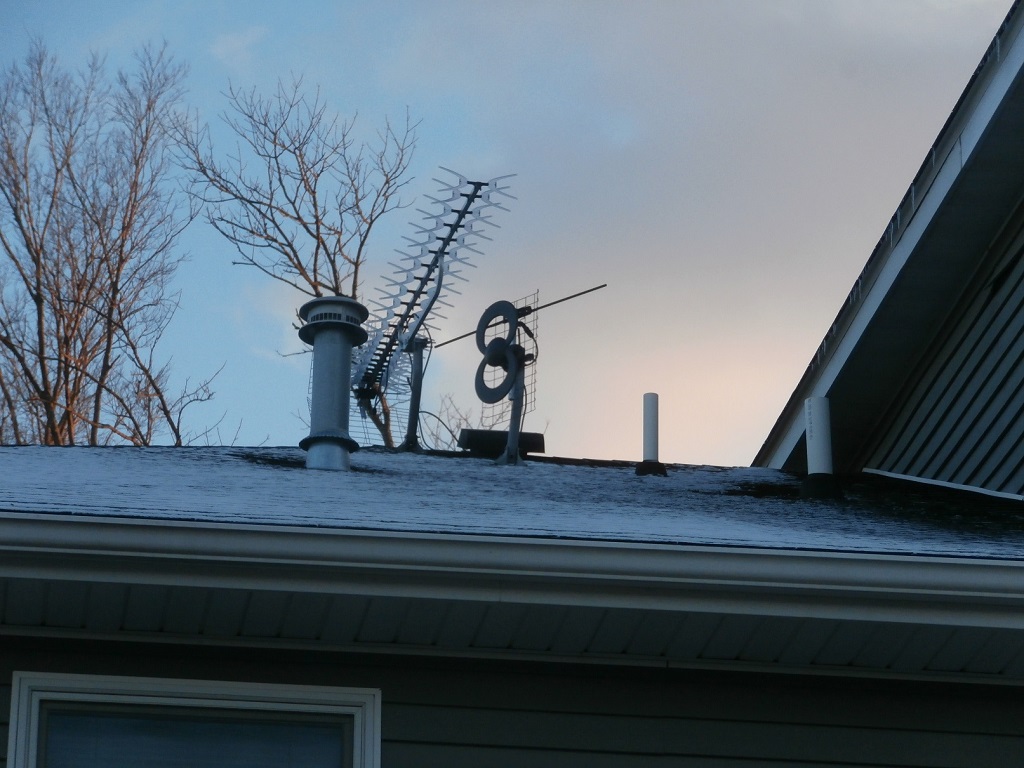

Originally Posted by mulliganman View Post
Let me clarify. I have a Clearstream 2V aimed at approximately 50 degrees. I have an Antennas Direct 91XG aimed at 349 degrees (this antenna is picking up Fox KRBK).
Is it safe for me to assume that you have your 91XG and C2V on the satellite mount that is located where the teardrop indicator is located on the satellite view of your house? It looks like it is on the East side of your house, about half way back from the front.
I don't have a photo of your antennas, so I'm trying to picture in my mind if you have both antennas on the same mast, and which is on top. I looked at some other map images to try to see how high your antennas might be, but I couldn't tell. My concern is whether the signals coming from the NE for the C2V are able to clear the roof of the house that is East of your house, because when I turn on the green signal lines for the interactive map, they cross the peak of the roof of that house.

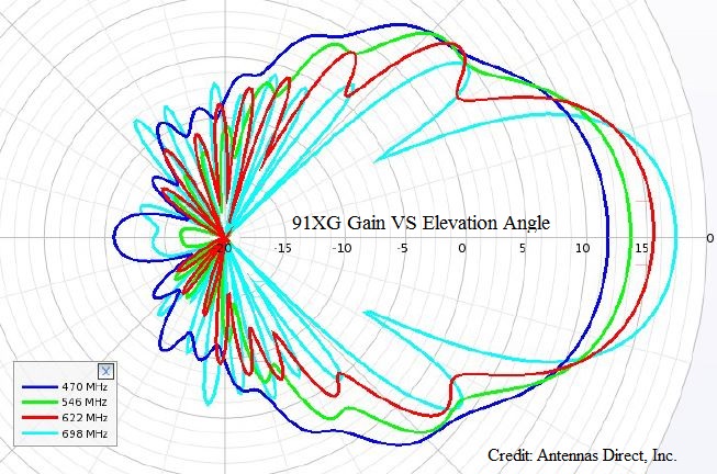

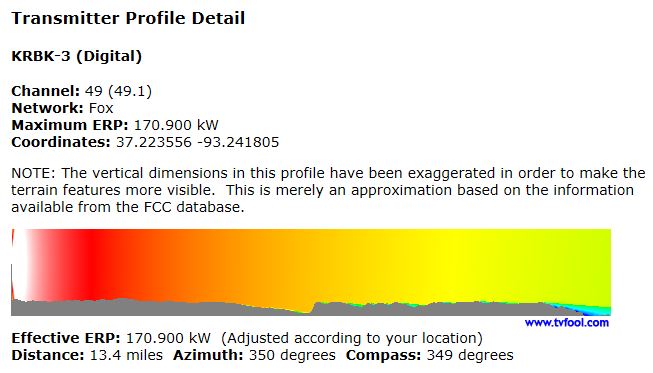

The 91XG has a tilt feature which would allow you to tilt the front of the antenna up for higher angle incoming signals like your 2Edge Fox signal on CH 49. Your location is at the right end of the profile:
Channel 49 is 683 MHz center frequency. Note the increased gain and more narrow angle at that frequency, which means the aim is more critical. Also note the notch at each side of the peak, which means a loss of gain at that angle.
Both antennas are using existing satellite mounts that were there already. The coordinates I gave you were pretty close to the area where both antennas are mounting. There is no mast in use that I am aware; just the satellite mounts.

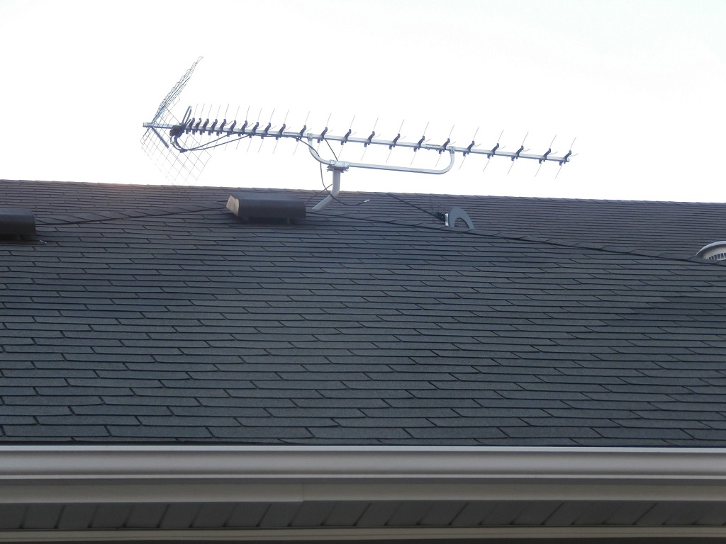

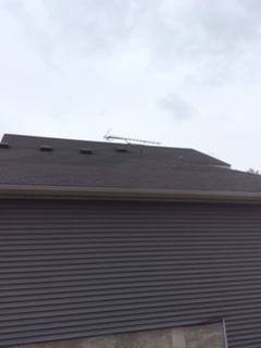

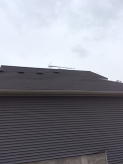

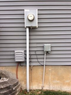

I've tried to upload some photos I took with my IPAD of the electrical system outside the house and the placement of the antennas. The pictures aren't the best but hopefully will do. The 91XG should be easy to make out and the C2V is just to the right of it in the photo.

Old 16-Nov-2014, 9:41 PM   #89
Thanks for the photos; they help.
Pic 1: Left to Right, that looks like telephone, power, and internet. Is that correct? I don't see an IBTB.
Pic 2 & 3: I see the 91XG, but not the C2V. I'm confused about the location. I thought the antennas were on the east side of your house. It looks like you were on the east side when you took the photo and the antennas are on the west side. Maybe I have the wrong house.
Old 16-Nov-2014, 9:57 PM   #90
mulliganman
Join Date: Jul 2012
Posts: 147
Regarding Pic 2 and 3, I was standing to the east of the house when I took the photos. I think taking photos with the IPAD is the only option because of the small file size requirement of this website (I believe my camera makes the files too large), so I apologize that they are not the best. If you are having trouble making it out, the C2V is close (just to the right of the 91XG when looking at the photo; probably a couple feet or so in real world distance).
Regarding pic 1 from left to right, it is internet, power, phone. You may need to rotate the photo. Looks like you are right regarding the IBTB.

Here are some new pics I took this evening. The side photos were taken on the right side of the home. The other pics were taken from the back of the home.
