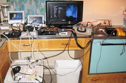

If I were there with you, I would want to add much more attenuation to see if the errors were gone while still having enough signal strength for the tuner. The reason I feel that way is because of the many comments by other Roamio users about it not being able to handle strong signals.

A DVR that can record more than one channel at a time must have more than one tuner. As ADTech said, there must be a splitter in the DVR to send the signals to multiple tuners. He and I both think that the DVR uses a zero gain splitter, which is a splitter with an amp that adds just enough gain to make up for the splitter losses.
You have already discovered that the TiVo values for SNR are not realistic because they are determined for cable use, not OTA use. It is my opinion that there is a similar problem with the acceptable levels of signal strength for the Roamio. The tuners are probably similar to the tuners in a TV, but the zero gain splitter was designed for cable signals that have a much more narrow range of strength than OTA signals. The engineer who designed the splitter was designing it for cable signals, not OTA signals, which could mean that it was never meant to handle such strong OTA signals.
There are two tests that you can do to see if my theory has any merit.
The first test would be to get several each of 10 dB and 20 dB inline attenuators to add to your attenuator collection. Add more attenuation between the C2V and the AC7 and see what happens to the errors; never mind about the signal strength as long as there is enough left for the tuner to decode the signals for proper reception. You have plenty of NM available before you get down to 0 NM. And you have plenty of dBm Pwr before you get down to -83 dBm, which is where you will reach the "digital cliff."

I can understand how that might be difficult. Your basement TV is a 60-incher; it is a lot of work to move a large TV. That TV is a Panasonic VIERA TC-P60ST60, which is a nice TV with good reviews.
What I want you to do as a second test is to disconnect the antenna coax from the Roamio and connect it to the P60ST60 to see how it behaves with the same signals that were going to the Roamio. The results might give us a clue about what improvements can be made to your antenna system.

There is no point in switching back and forth, because the signals would have changed by then, which is why I had suggested the two-set comparison which gives you a real-time comparison.
What I'm suggesting now is a second-best test because it would be difficult for you to bring a second set down to the basement, unless you have or can borrow a smaller set.
You already know what the Roamio does with the present antenna system. I want you to see what a TV does with the present antenna system.

When I was calibrating an Apex DT502 converter box for a friend, I received a mild shock when I touched the equipment and the metal strip on the front edge of the counter. The strip was grounded because it touched the metal stove top.
All AC operated equipment has leakage current. Just because you can't feel it doesn't mean that it isn't there. All these pieces of equipment were connected together by a 4-way splitter, and were operating normally in that their individual leakage currents were within safe limits. But, since they were connected together their leakage currents added together, and that's why I felt a mild shock. The setup was using a temporary outside antenna that was not grounded. When I grounded the splitter, the leakage current went to zero.
Having three close calls with electrical shock, I consider the grounding block essential in any antenna system.
