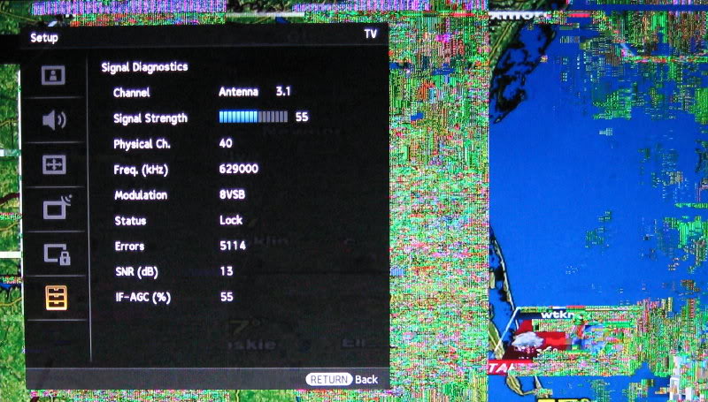

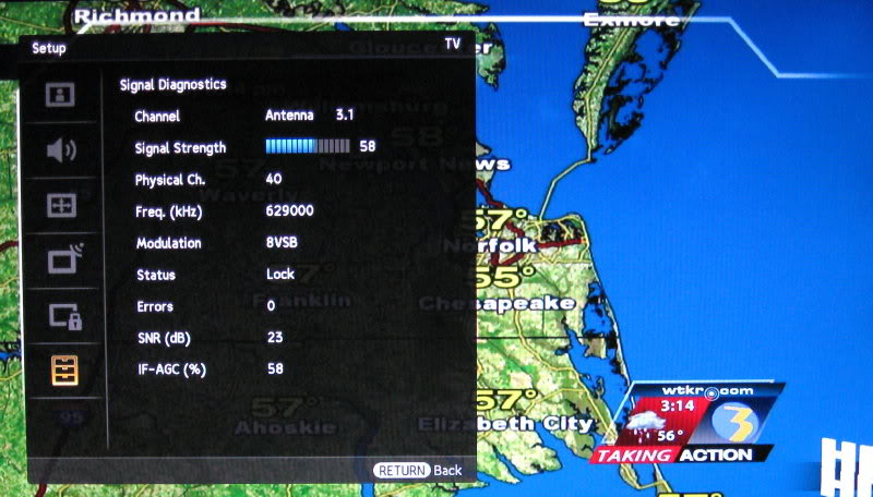

My newest TV is a SONY KDL32R400A. Using a splitter to send a signal to the TV and my SLM, I measured the signal level at 100 on the Diagnostics Screen signal strength scale and it was +40 dBmV, which is equal to -8.8 dBm. The engineer who designed the circuit must have been reading ASTC A/74.
In this country engineers use the symbol dBm for signal power; antenna installers and cable guys use dBmV. Other countries use dBμV (note the little tail on the u which means "micro"), which is dB microvolts. It's also signal power but its reference level is defined in microvolts. The conversion factor between dBmV and dBμV is 60, so 40 dBmV is equal to 100 dBμV, which is what the Sony engineer was thinking. 100 on the signal strength scale equals 100 dBμV.....nice!
I then inserted a variable attenuator (using the method described in the link in my signature) and brought the signal level down to dropout, which was about -85 dBm and noticed that the units on the signal strength scale were equal to about 1 dB. So, I was getting a TV and a signal level meter for the price of a TV.
My older SONY KDL22L5000 signal strength reading never gets up to 100 no matter how strong the signal. The reading is derived from the AGC (Automatic Gain Control that controls the sensitivity of the tuner) voltage. The newer SONY must have a different type of circuit, perhaps an RSSI chip like in cell phones which gives you strength in bars.
I had a chance to measure another R400A, and it gave me the same reading at 100 on the signal strength scale.

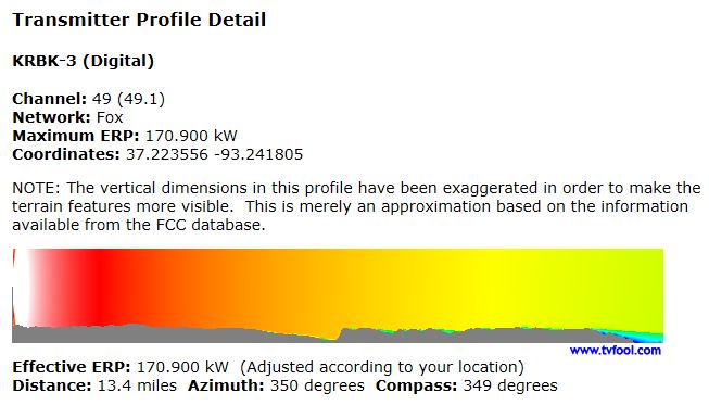

The simulator calculates that the KRBK signal path switches from 1-edge to LOS between 105 and 110'.
However, given that the resolution of the digital elevation model used for the simulator may easily have 5 or meters of vertical error and the cell in which it places each elevation for the complete signal path evaluation is either a 30 or 100 meter square, it's far from a precision calculation.
An LOS signal path is not a requirement for solid reception (but it sure helps) and most people who use antennas rely on paths that calculated to 1-edge or 2-edge paths. The important thing is to get the right antenna into a spot that happens to coincide with a signal that's "good enough". Goldilocks, if you will.

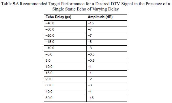

I guess we have concluded the 10-1 is due to VHF being more susceptible to interference...
Yes, electrical interference is greater on VHF. It could also be from multipath reflections coming from other directions because of the simple Vhf antenna. Again from ATSC A/74:
A more directional VHF antenna would reject many of those reflections.
Note from the table that the greater the difference in time between the main signal and the echo (reflection), the weaker the echo must be to not interfere with reception.
How often do you see the uncorrected errors? Once-a-day for a few minutes, or more like almost constantly?
Do you see picture and audio problems on your TV only when you have errors?

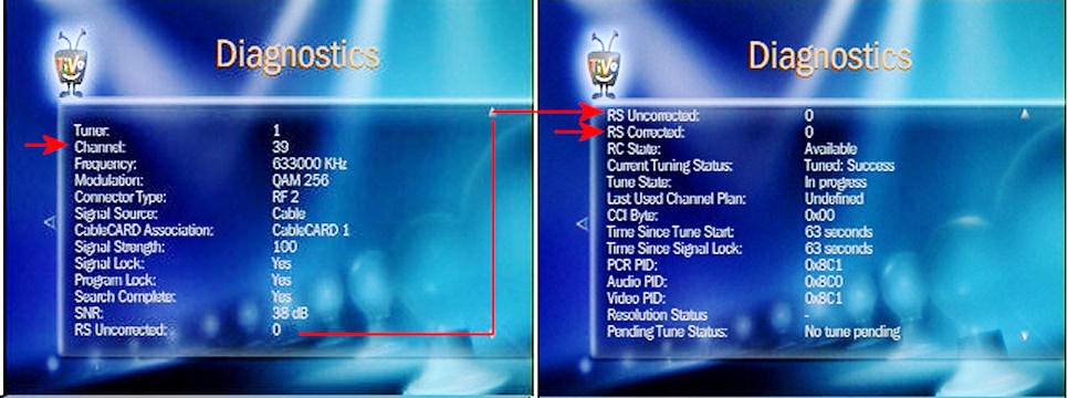

3. Navigate to the DVR Diagnostics screen:
From TiVo Central > Settings & Messages > Account & System Info > DVR Diagnostics
4. Under Tuner 0, look at the channel number. If the channel listed is not the problem channel, press Chan Down until you see the information for Tuner 1 (if you have a 4- or 6-tuner TiVo DVR, you might need to continue scrolling until you reach the correct tuner for the problem channel).
and found this document from TiVo: (link no longer available, do Google search)
Troubleshooting Digital Cable Signals: Roamio Series, Premiere Series, and Series3 DVRs
http://support.tivo.com/app/answers/detail/a_id/150
It had some images for the Diagnostics Screen. I copied the one for the errors, and edited it to make it a little lighter because the original was too dark:
RS is short for Reed–Solomon:
https://www.google.com/?gws_rd=ssl#q=RS+errors
http://en.wikipedia.org/wiki/Reed%E2...ror_correction

KTKO-LP digital and KTKO-LP analog are both very weak. No surprise there either, because of their very negative NM numbers, based on your old report:
http://www.tvfool.com/?option=com_wr...d24362e8886d03
