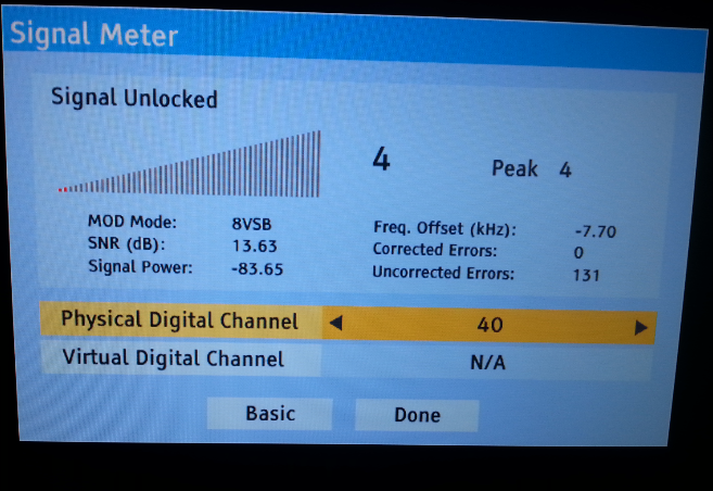

Here is a screenshot of the data from the channel I'm struggling with. I don't know that is all that helpful other than as a comparison to other channels and being able to tweak location/direction. At the very least it's interesting.
The model is Toshiba 32HL67.

I have to say that that is the FIRST TV set I've seen that had a signal power meter like that, a real one!. Too bad its a seven year old model, otherwise, it could become very popular with OTA folks.
There are three particular numbers on that screen that are useful:
1) SNR. ATSV requres a bare minimum of 15.2 dB while 20 dB provides some fade margin. Your screen is reporting it's a bit shy on that station.
2) Signal power. ATSC requires a minimum of around -83 to -85 dBm signal power. Your reading is right on the edge but, with insufficient SNR, it still doesn't work.
3) Uncorrected errors. Ideally, this would be zero when receivable signals are present.
Your task is improve both SNR and signal power. SNR is best improved by getting a stronger signal at the antenna terminals. This can be achieved by installing the antenna in its most favorable available location so that more of the desirable signals can be gathered by the antenna. Moving to a higher gain antenna would also be expected to improve the SNR.
Signal power, after first improving your SNR, can be helped by a modest pre-amp, one selected so as to minimize noise figure, with good overload resistance, and an enough gain to overcome all the downstream insertion losses plus a modest margin. You already have one of those.
Something doesn't compute in your setup and numbers. TVF predicts a signal power of -55 dBm and the 751 has a few dB of real gain on UHF. Let's assume a signal power at the antenna terminal of -50 dBm. The RCA should have around 22 dB of gain and a noise figure around 3 dB on channel 40 according to a sample I tested. Assume 50' of RG6 (-3 dB) and -8 dB insertion loss for a four port splitter. That means that the signal power level at the tuner should be around -40 dBm. You're more than 40 dB short, a very, very, very considerable amount.
That means one of several things: Either the signal power at the antenna isn't as predicted due to obstacles in front of the antenna or you have some excessive losses in the rest of the system.
Are there trees or any buildings in the line of sight to WILM?
Have you verified that the amp actually works?
Have you runs a single, know good length of coax straight from the antenna to that Toshiba?
The WILM antenna is side mounted on the tower. Such a mount often causes deep nulls in the transmitted pattern, but usually not 40 db.
The WILM antenna is circularly polarized, which means that there is as much vertically polarized signal as H-pol signal. When side mounted, the nulls caused by the tower are different between H-pol and V-pol. That suggests that twisting your antenna so that the elements are diagonal (45 degrees) may offer a solution that you can try. You'd loose 3 db on signals that are only H-pol and pick up much more than that if there is a V-pol signal in the air at your house.

It's the trees, in my opinion.
I've seen situations "out in the woods" with my spectrum analyzer where signals can vary as much as 20-30 dB on some channels (but not others) just by moving the antenna a few feet. On another occasion, I've been within visual line of sight, excluding trees, of a million watt UHF site here in St Louis, and a single big silver maple tree in full leaf would completely wipe out reception of that station when the antenna was behind the tree and the wind was blowing. Moved a hundred feet off to the side and the signal measured as expected on the analyzer.
Best course of action I've found is the combination of the following:
1) Largest UHF antenna feasible for the situation (might call for a Yagi, 4 bay or 8 bay).
2) Mount the antenna as far back from the trees as possible.
3) Mount the antenna as high as possible.
4) Boresight the antenna to the visual horizon at the treetops.
5) Judicious use of a preamplifier to preserve whatever signal might be at the antenna's terminals.
That's it, short of making firewood out of every tree that's confounding your reception, building an extraordinary tower above the trees, or calling United Van Lines.
I would certainly suggest trying the 4-bay UHF antenna. Your odds will be substantially better. Be very flexible on selecting its mounting location and don;t drill any holes until you're satisfied that reception is as desired. If you have VHF channels on your "must have" list, you may well need to address them separately.
