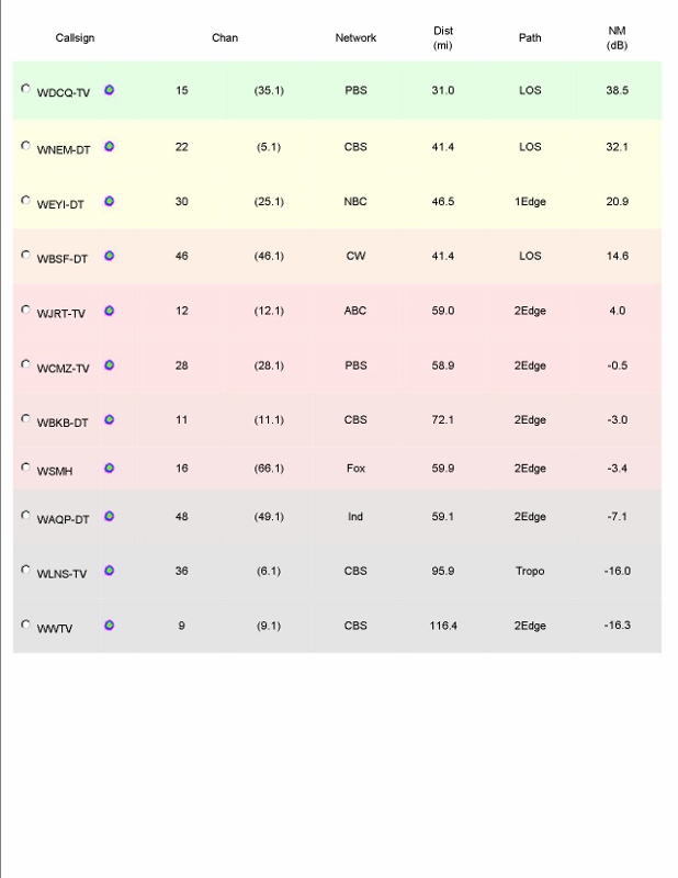

I have an old, beat-up radio shack antenna, one of the classic multi-vaned 8’ long ones, in my attic that is sort of pointed north of where it should be; I hooked it up to my new insignia tv through a signal booster and I get WNEM and WDCQ just fine, but nothing else. The antenna is in the attic because I took it off the outside pipe and moved it inside after getting tired of picking up pieces of it every time I mowed. It’s missing quite a few elements, and the plastic joints are pretty well shot with age and abuse. I would much prefer to put the new antenna in my attic because I live where it’s always windy.
I've attached the results from tv fool using the mapping tool so it’s accurate to my actual location. I hope you can see the chart. (This was done at the default height of 10’, but in the attic it will be about 18-22’ above the ground and if I can fit it in properly, will be looking through the wall with vinyl siding and not through the roof with two layers of asphalt shingles).
I confess I don’t quite understand all of it. My desired channels are WNEM, WDCQ, WEYI, WJRT and WSMH.
I read a post on these forums (http://forum.tvfool.com/showthread.p...light=Michigan)
And that person seemed to need a lot of the same channels, though probably from the opposite direction, based on what he said. (I’m in Michigan’s Thumb). The recommendation was for a HBU44, however when I look at that, from what I understand it would not get WNEM, since it is channel 5. Or doesn’t that matter since the chart says 22? And at antenna craft it says “CEA rated red” – what does that mean? Is it some reference to the colors in the chart?

Please post the actual LINK to your report as per instructions, the attachment provided is not of any use.
Please refer to the "Real" channel column in the Radar Plot for the operating channel (which determines antenna requirements), not the "Virtual" channel as they are often different.

Question 1: Based on the channels I wish to watch, (WNEM, WDCQ, WEYI, WJRT and WSMH) can anyone interpret the chart for me and advise if I need a VHF-UHF antenna, or simply a UHF? I'm going to buy a new antenna and would like to know which type I need. I've grown up with Channel 5 being a VHF channel but in the new digital stuff I'm not sure anymore.

As you look at your TV Fool report, pay attention to the 'Real Channel' column... Real channels 14 and higher are UHF. There are two separate bands of VHF channels and therefore not all VHF antennas are designed to receive all VHF channels. the L-VHF band includes real CH-2 through CH-6 and the H-VHF band includes real CH-7 through CH-13.
So based on the limited information available, it would appear that you need UHF and H-VHF capability. If every signal comes from the same direction, a single combination antenna may work very well... but it's unclear what your situation looks like.
WNEM – real CH-22, UHF
WDCQ – real CH-15, UHF
WEYI – real CH-30, UHF
WJRT – real CH-12, H-VHF (The weak NM value suggest that you'll need a dedicated H-VHF antenna such as the Antennacraft Y10713 pointed directly at this signal. Attic mounting is quite unlikely to provide reliable reception of this signal.)
WSMH.-- real CH-16, UHF (Also very weak, indicating the need for a full size UHF antenna such as the Antennas Direct DB8E. Attic mounting is quite unlikely to provide reliable reception of this signal.)
You did not include WBKB – real CH-11, H-VHF (If you want this signal, it's quite weak and will need the largest available antenna or possibly a tall mast or tower.)
I have no way to suggest how to aim due to the lack of that data. Both of the antennas I've mentioned are quite directional. They can be combined using an RCA TVPRAMP1R which has separate inputs for UHF and VHF. Or, you can use a passive UHF/VHF signal joiner ahead of a single input preamp. If you have signals arriving from multiple directions, you may need to consider an additional UHF antenna that terminates in an auxiliary tuner. Combining two antennas that cover tha same band, but are aimed for reception of different signals will generally be difficult or impossible to combine. http://forum.tvfool.com/showthread.php?t=2882

No, I'm not interested in going after WBKB. Not worth the effort. Aiming for the rest shouldn't be too much of an issue, all of the stations are southwest of me, and when I look at the radar plots I'm within the dark blue shades even with the weaker stations, so I am hopeful. Based on your feedback I may go ahead and mount the new antenna outside to begin with, rather than in the attic.
