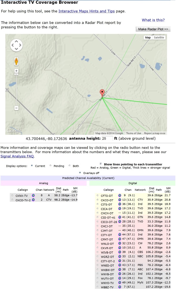

I used tvfool.com for the attachment and the below link
http://www.tvfool.com/?option=com_wr...e1c63c658e0af9

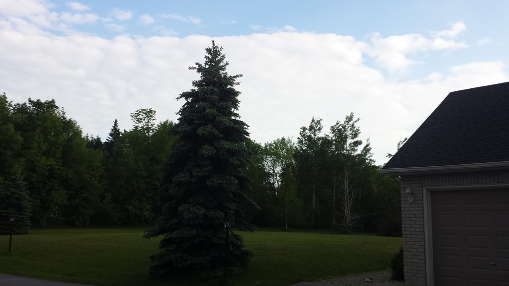

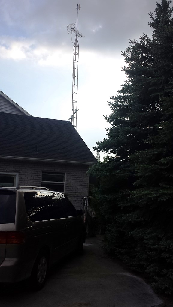

I also attached photos of the current non working antenna as well as a photo of the tower and our treeline.

As always , trees and tree leaves , plants and plant leaves , have a Negative Effect on Broadcast Tv Reception and so do buildings and other obstructions including your own roof and building.
Some and not all Negative Effects are.
Absorbing and Blocking Reception.
Multi-Path Reflecting Tv Signals Bouncing All Around.
The Best Practice for Reliable Reception is to install antennas at a location that has the least amount to no amount of obstructions of any type or kind in the directions of reception including your own roof and building.
The directions of reception at your location are , South East , South , South West , East.
The closer all types and kinds of obstructions are to the antennas , the more the reception will be disrupted.
It is Ok to cut down trees that are close , in the directions of reception.
The directions of reception are , East , South East , South , South West.

If you want the C***-DT stations and the W***-DT stations, I think your best bet would be two separate antenna systems.
All the US stations on your plot are UHF, so any of the high gain UHF antennas would work (DB8e, CM 4228, 91XG). Put the US station UHF antenna as high as safely possible. If you put it on a rotor, you can fine tune the aim from the ground. You would want a low noise preamp, possibly a PA18 (or a KT200 in a weather proof enclosure). I think you are far enough from your closest stations for a low noise fringe amp to not overload. Aim the antenna around between 126 and 133 degrees true. The rotor would be helpful to find the exact best place to aim it for the US stations.
The Canadian stations are a bit spread out. Some of the ones off the main group are strong enough they would probably be picked up by the US antenna or by an antenna for the Canadian stations. You could use a VHF/UHF antenna for the Canadian stations, or you could use separate antennas for them. I would lean to separate because that gives more mounting flexibility. Starting with the VHF stations, if you want CFTO on RF9 and CKCO on RF 13, I would get 2 Y10-7-13’s. I would get a CH13 jointenna from http://www.channelmasterstore.com/JO..._p/cm-0583.htm Then put the antenna pointed at CKCO on RF 13 into CH13 input and the antenna pointed at CFTO on RF9 into the broadband input. That should give you an incredibly solid signal for two VHF stations from different directions. The VHF signals should be the most forgiving, so they can go the lowest on the tower, below UHF antennas. For the Canadian UHF stations, pick a good UHF antenna (DB8e for example) and point it at 96 degrees true. It should go next highest on the tower after the US UHF antenna. I would use a TVPRAMP1R to merge the CH9/13 feed from the jointenna with the signal from the Canadian UHF antenna.
For a separate two antenna systems solution, do not try to merge the US coax with the Canadian coax. Either have an AB coax switch at the TV, or use some sort of external tuner for one system and the TV’s built in tuner for the other system. (The one exception to that being VHF. All the US stations are UHF, so you could split the Canadian system after the power inserter, send one side to your viewing device(s), and the other to the V terminal on a UVSJ. Then take the US system’s output from the power inserter and feed it into the U terminal on the UVSJ. The combined terminal on the UVSJ will have the US UHF stations with the Canadian VHF stations.
If you really want to merge the Canadian and US channels properly, you will need a heterodyne processor for every station you want to put on the same coax. A single digital heterodyne processor would blow your $700.

Looking at current versus pending the Canadian channels change a lot. There is also the possibility the Canadian information TV fool uses is out of date or incomplete. With that being said, it may be of limited value to put lots of money and effort into getting Canadian stations.

How is the tower supported? Is there a gable bracket? Does it have a tilt down base.
Does the tower appear to be in good physical shape? Is there rust? Are any sections bent/bowed/compromised?
Working on towers can be dangerous. Climb it at your own risk. When in doubt, contact a professional.
Is the tower grounded? The top of the tower/antenna(s)/mast could be an attractive target for lightening. Measures should be taken to provide a low resistance/low impedance path to ground. Amateur radio books are a good source for grounding guidance. As a start, an 8’ ground rod should be at the base of the tower connected with as short and straight of a run of heavy copper as possible. Beyond that several ground rods should be spaced radially from the tower 16’ away from the base rod and each other and it all tied together with heavy copper wire or strap.

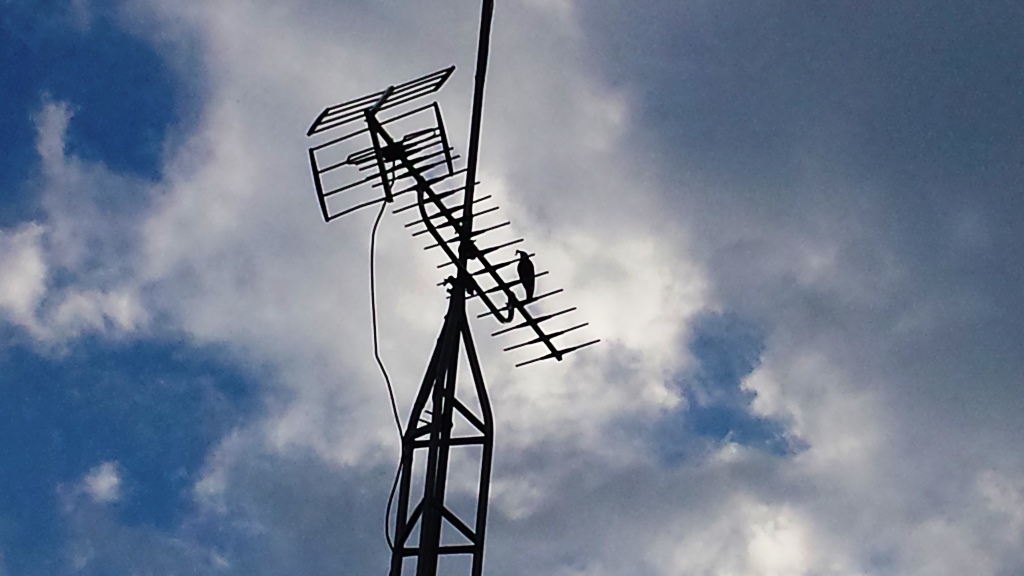

The antenna in the attached picture looks like it is in good shape. The coax may be the weak link. It looks bent/kinked. It looks like it has whipped around in the wind by not being well secured to the tower.
What type of antenna is on the mast above the UHF yagi at the top of the tower. Could you post a picture of it?

I believe the tower is mounted to the ground. I will double check tomorrow.
Tower looks to be in excellent shape no rust,broken parts etc.
Not sure if the tower is grounded. I will have to look into that too.
You might be right. The coax could be the problem. Man you have a good eye !
The upper antenna is for the internet. Nothing to do with TV. If you still would like a photo I would be happy to post .
