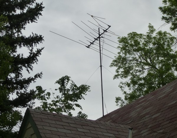

I'm just recently trying to get my OTA set up working again, after not using it for years. Old Sony tube Trinitron with a digital Magnavox SDTV converter. When OTA first went digital, I recall getting a bunch of stations, some clear, some not so much. I'm in Fort Collins, CO. Here's my signal report.
So last week I fired things up, and receive exactly ONE channel (well, really three): digital 6.1, 6.2 and 6.3. KRMA-DT comes in just fine, but I get nothing else. I reset everything, did a double-rescan of the converter box, but still just digital channel 6. It comes in nice and clear.
The antenna on the roof appears to be an old VHF unit. It was there when I bought the house almost two decades ago, in the dim pre-cable past. I've never gone up to look at it; it has a flat 2-conductor cable coming off it (see attachment).
My question: I used to get a bunch of channels. Why now do I get only one, just fine, and no others?

That antenna and down-lead have obviously seen better days. There are one or more broken elements and I suspect that the cable is well weathered. All this adds up to plenty of reason to expect the antenna to be far from it's original tuned state and any signal picked up, may or may not have a path to the tuner. Just some random bit of wire attached to the tuner can act as a crude antenna, but the results will be unpredictable.
If you don't want to take advantage of the free HD and SD programing available to you, I won't waste your time with an antenna suggestion.

Different frequencies behave differently, depending on distance, height, reflections, etc.
If it's not of that much interest to you to find a solution, you may not care to waste a lot of time worrying about it.

Your description of the situation provides the answers you seek.
Old antenna , twin lead antenna wire , and other problems that have to do the old defective componets.
You are not interested in doing a Correct Installation so

I also agree w/ GUM, in that just by sheer coincidence, the lead in wire is capturing some signal and not the antenna itself.

Update: thanks to the links here and $20, I now have a Stealth Hawk 289 up on the side of the house, a bit lower than the roof antenna--about 18'--and am pulling in many of the stations in green on my signal report. Apparently, yes, channel 6 previously was a lucky bounce.
