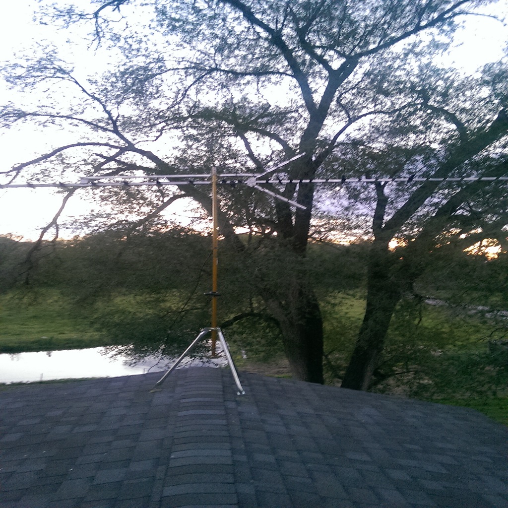

Old 2-May-2014, 2:21 AM   #20
bwag32
Join Date: Mar 2014
Posts: 39
ok killed everything at the circuit breaker . ran a brand new 25ft cable to the tv and scanned only got 3 channels. here is a few pictures of what I am dealing with. Keep in mind that on these trees there is the same amount of leaves as when it was working .just tell me I am screwed if that is the case lol
