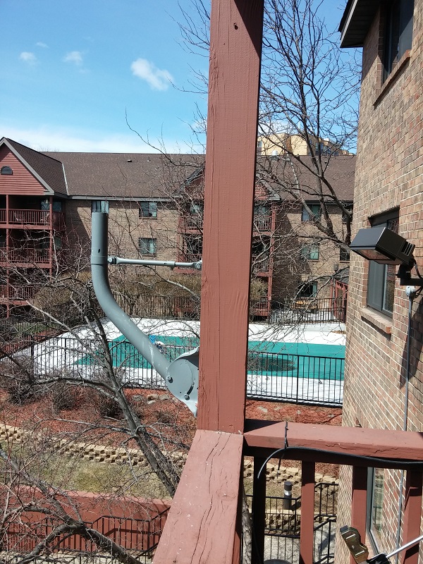

Also I have attached photos of my position:
anntena01 is what it will be pointing through.
anntena02 shows my old mount for directv, I will be moving this to the other side of pillar.
Thanks again, and let me know what you guys/gals think!

If the Tv transmitters are in the direction of the pictures that has what looks like a Big light tan colored building in the back ground.
Then leave the satellite mount on the side of the pole in the picture.
Moving satellite mount to the other side of the pole so that the Tv antenna is aimed more into the tree in the direction of reception is not the correct action to take.
As always , trees and tree leaves , plants and plant leaves , have a Negative Effect on Broadcast Tv reception and so do buildings and other obstructions including your own roof and building.
The Best Practice for Reliable Reception is install the antenna at a location that has the least amount to no amount of obstructions of any type or kind in the direction/s of reception.

I agree with teleview, leave the J-pole on the outside of the beam. Based on your TV Fool report, even with 2-Edge signals you might get decent reception from there with the ANT751. As always, higher is better so if you can move the J-pole up or get an extended J-pole like this;
http://www.amazon.com/Distributed-By.../dp/B00EI8LYJQ
You might just be able to get good signals, that location is close to clearing the nearby building and at the outside beam you are almost clearing the tree. Aim the antenna up (toward the sky) about 5-10deg to maximize reception.

I will give the aiming suggestions a try. When I earlier tried to swing the antenna to the proper heading, from the current j-pole position, the wooden pillar got in the way. But it looks like from your amazon link there are many great options for poles that will help get around this!

The antenna will be in the horizontal plane , flat with the ground.
You can install the antenna on the side of the pole that is in the direction that the picture is looking at.
The point is , to avoid installing the antenna at locations that the reception will be more obstructed.
That apartment building that is in the direction of the picture is looking at is disrupting reception.
Home Depot has , 10 foot 6 inch lengths , 1 and 3/8 inch diameter , TOP RAIL , chain link fence , PIPE , that makes good antenna mast to get the antenna up higher.
The 1 and 3/8 inch diameter pipe will most likely fit inside the satellite mount pipe.
